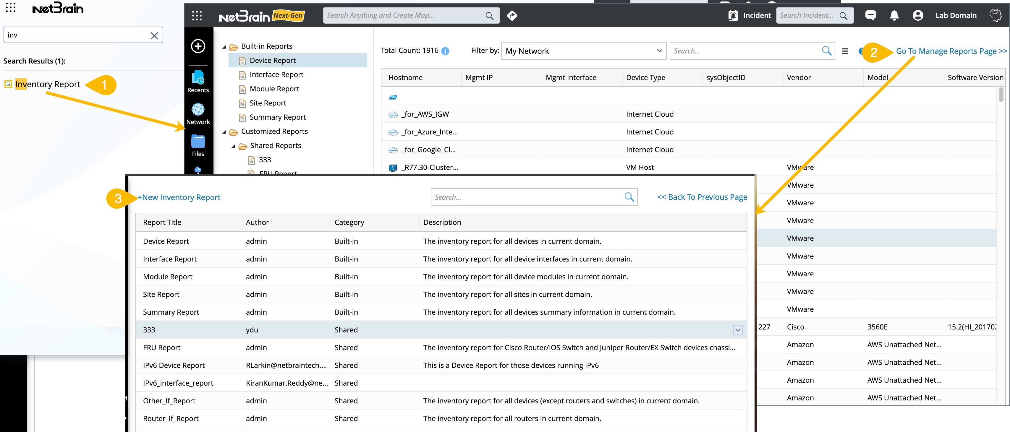

  1. Click the start menu  and select Inventory Report.
  2. Click Go to Manage Reports Page at the upper-right corner.
  3. Click New Inventory Report on the new page. A wizard prompts to guide you through the steps to create a report.

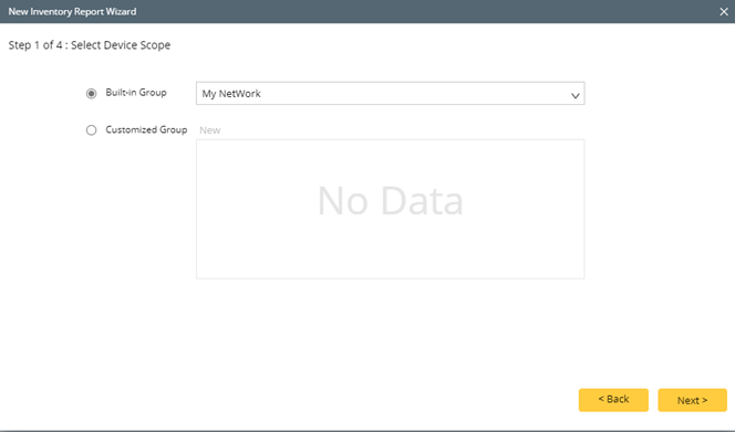

    1. Specify the devices to be included in the inventory report using one of the following ways and then click Next.
      • Built-in Group — select a site, device group, or device type as device scope.
      • Customized Group — click New, and then filter the devices, interfaces, modules, and the like, by setting criteria in Dynamic Search.

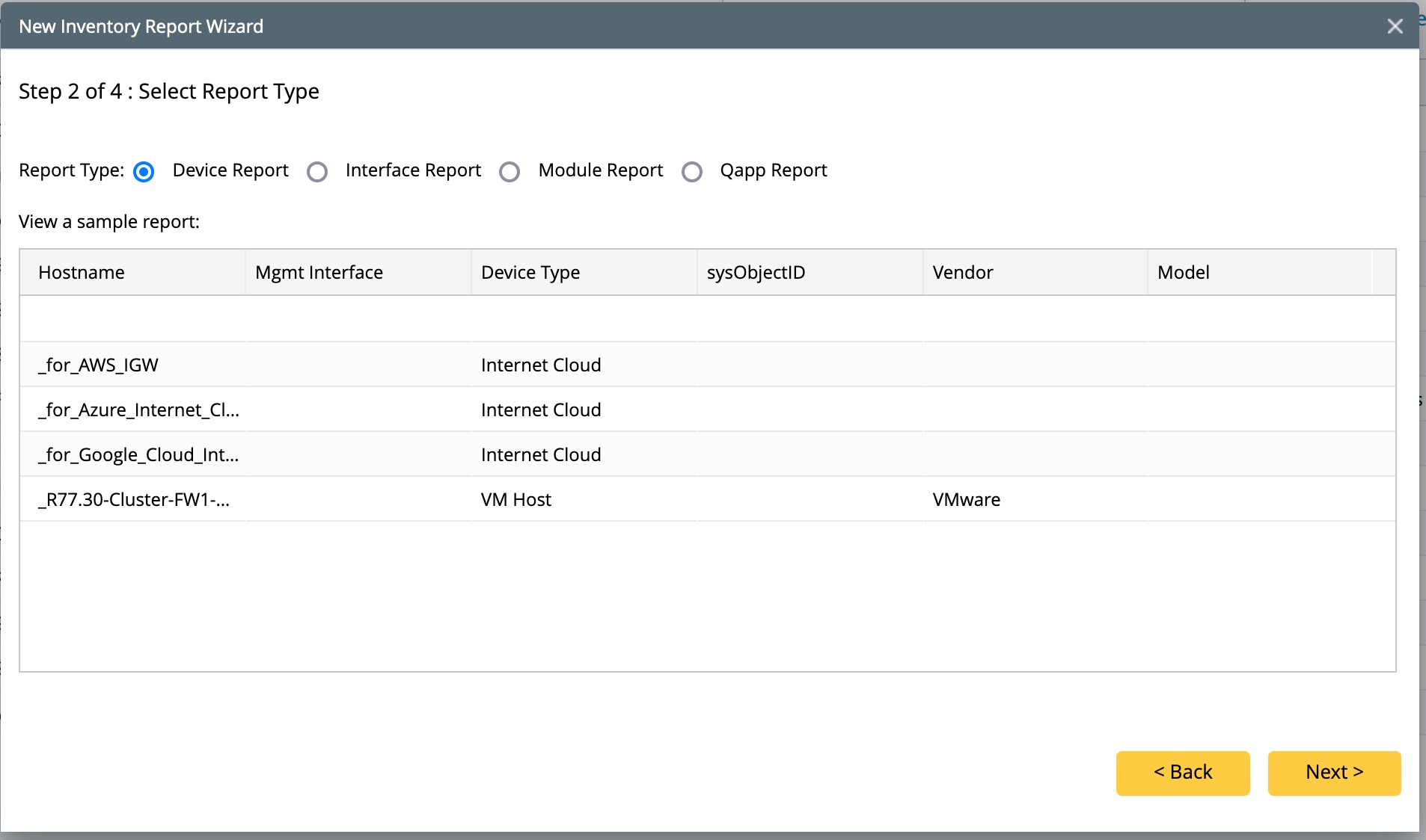

    2. Select a report type, and the corresponding sample will be displayed for reference. Click Next.

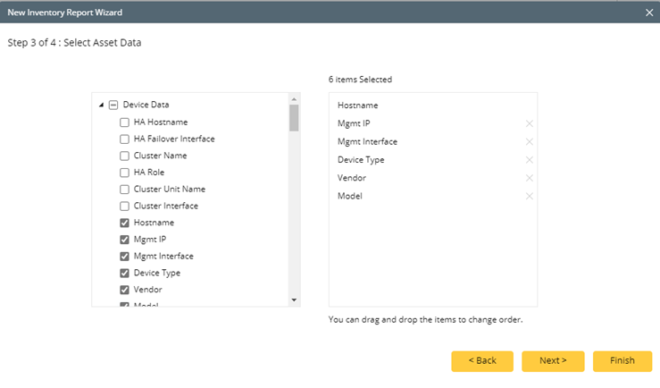

    3. Select the asset data that you want to include in the inventory report. Click Next.
      Information Note: This step differs as per the report type selected in step 2. If you select Qapp Report as the report type in step 2, you will have a different dialog for step 3. See Customize a New Qapp Report for details.
