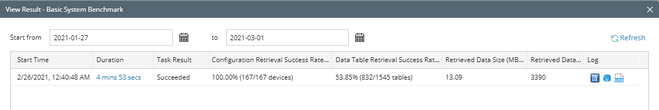

Verify the following items in the View Result window:
  • Check the task result and make sure all tasks are successful without any warnings.
  • Check the duration to make sure the execution time is reasonable
  • Check the start time and duration to ensure the Benchmark task does not overlap with other scheduled tasks. See recommended settings in frequency for details.
  • Check the Configuration Retrieval Success Rate and resolve the devices with configuration retrieval failures.
  • Configuration Retrieval Success Rate is the ratio of the count of devices that successfully obtain the config over the count of devices that try to obtain the config.
    Information Note: 'CLI Try Failed, SNMP Try Succeeded' is considered Config Retrieval Failed.
  • Check the Data Table Retrieval Success Rate and make sure there is no sudden change compared with previous tasks.
Data Table Retrieval Success Rate is the ratio of the count of data tables successfully obtained over the count of data tables that are tried to obtain.

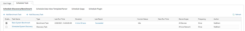

Follow the steps below to browse benchmark logs:
  2. On the Domain Management page, click Schedule Task on the Start Page.
  3. A picture containing table
    Information Tip: You can view the latest execution result of all benchmark tasks from the Last Result column. To view the detailed latest execution log of a benchmark task, click the hyperlink (such as Succeeded) in its Last Result column.
  4. Right-click the target task entry and select View Result from the drop-down menu .
  5. In the following dialog, all execution results will be listed.

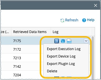

    Note: In the drop-down menu, you can export the logs and delete the execution result. Multi-select is supported.
