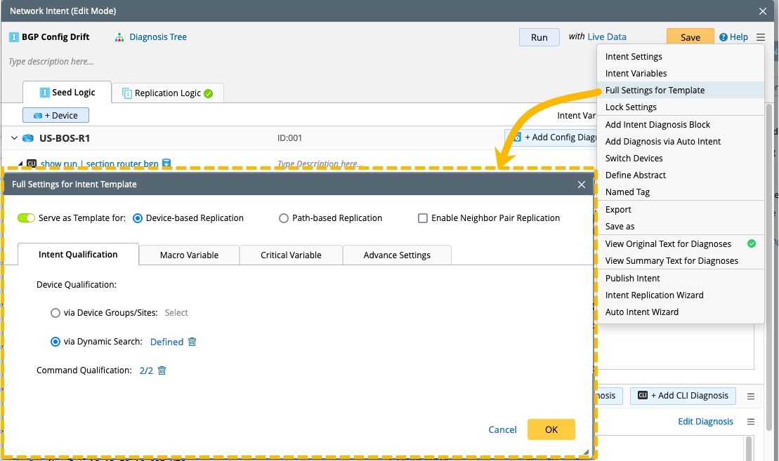

Define Full Settings for Template
If you want to define more detailed settings for the intent template replication, you need to open the Full Settings for Template dialog and define more additional settings in it.

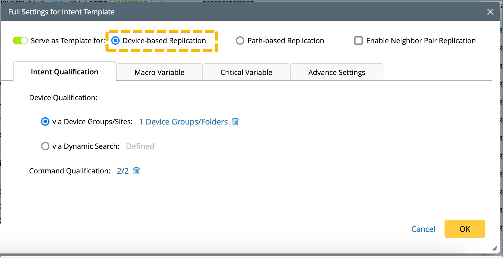

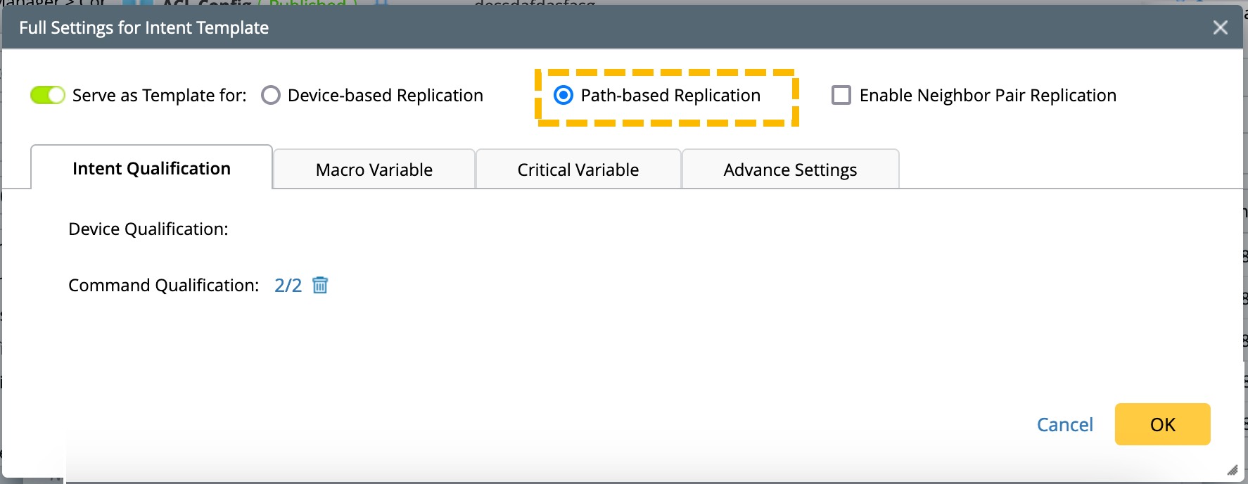

Intent Qualification
The qualified devices can be defined in the following three methods:
  • Defined via dynamic search.
  • Defined via device group/site.
  • Defined via Command Qualification.

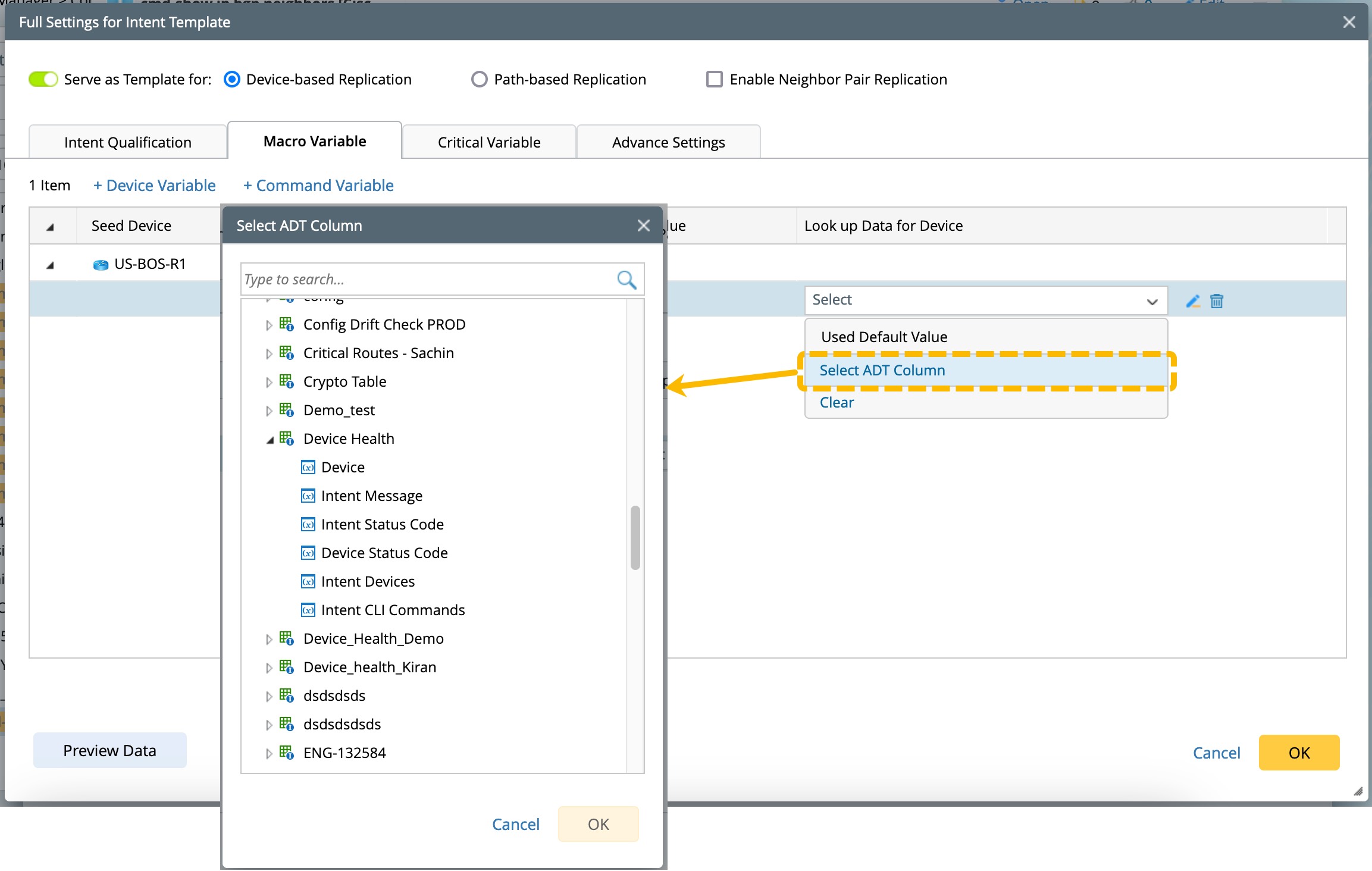

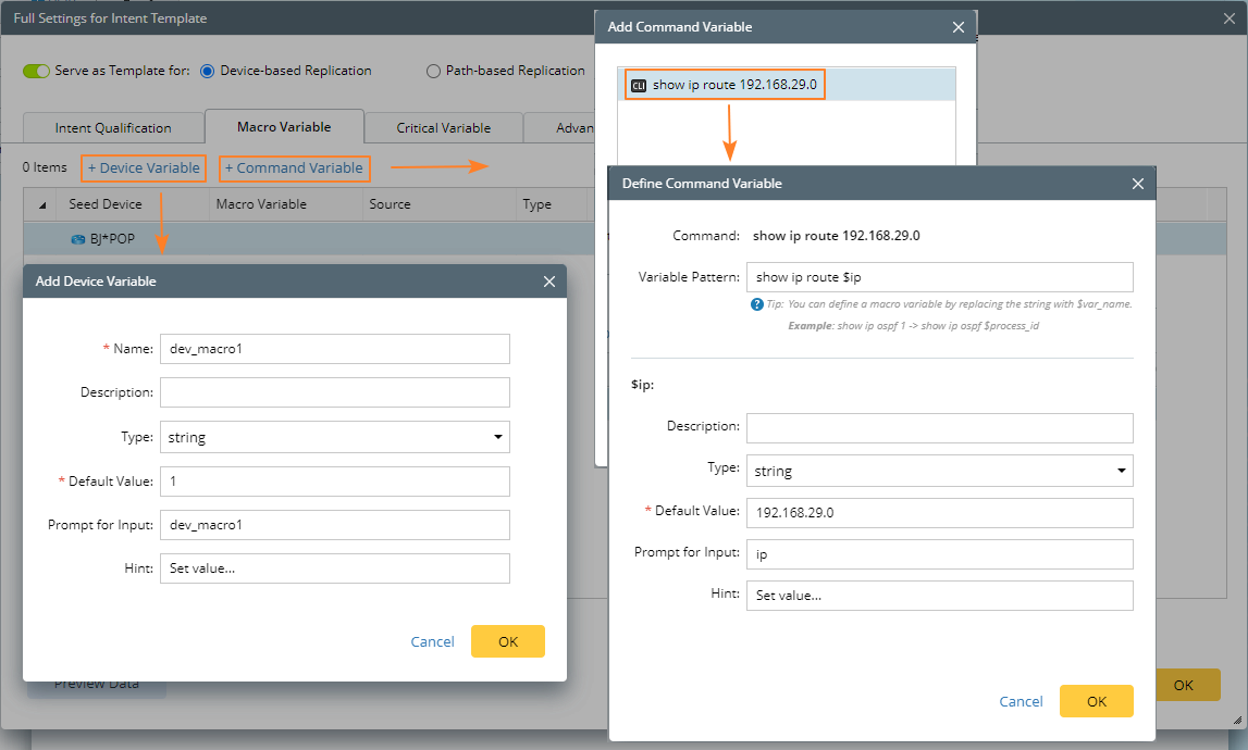

Manage Macro Variables
You can define the Command Macro Variable or Device Macro Variable here.
The main use flow of macro variable is as follows:
  1. Define device/command macro variables.
  2. Select the ADT to decode the macro variables.
  3. After the definition, navigate to the Macro Variable tab to manage them.

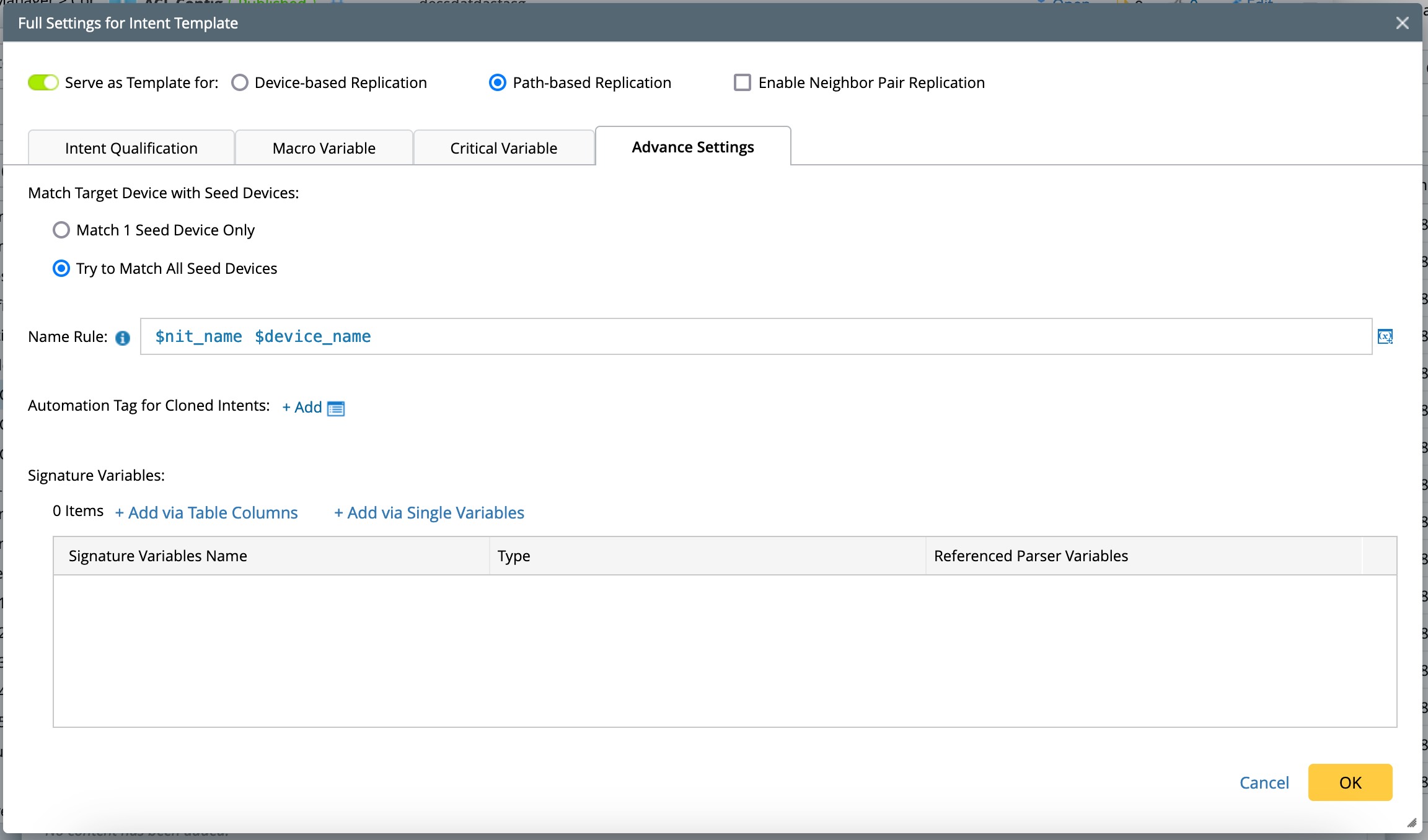

Advanced Settings
You can define the Name Rule, Automation Tag, and "Match Target Device" logic here. The "Match Target Device with Seed Device” is to control whether only one seed device is matched or all seed devices are matched when replicating, and the Try to Match All Seed Devices check box is selected by default. You can also define Signature Variable here.
