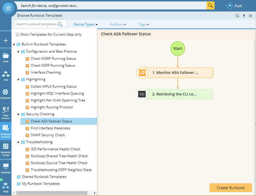

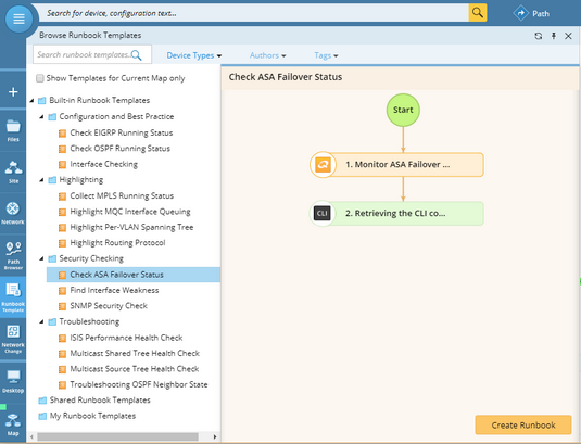

1.On a map with Cisco ASA firewalls, click Runbook Template on the taskbar.
2.In the runbook template tree, select Security Checking > Check ASA Failover Status, and click Create Runbook.

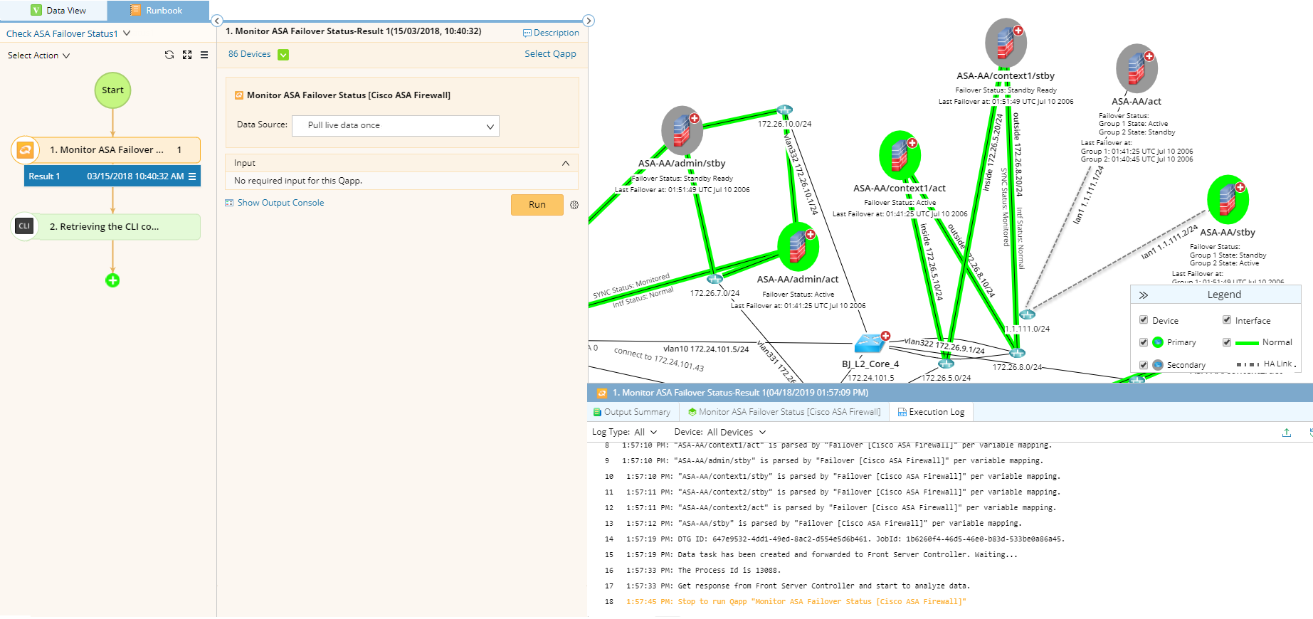

3.In the Monitor ASA Failover Status Qapp node, add target devices, select Pull live data once in the Data Source area and click Run. The active and standby status of ASA firewalls is displayed on the map. According to the legend, the ASA-AA/act firewall becomes secondary but the ASA-AA/stby firewall becomes primary. You can click Show Output Console > Execution Log to view the detailed log regarding how the Qapp retrieves data from target devices.

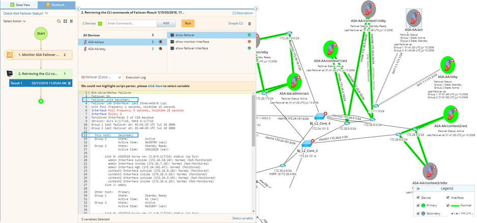

4.In the Retrieving CLI commands node, select ASA-AA/act and ASA-AA/stby as target devices, and click Run. From the output result, the status issue is verified.

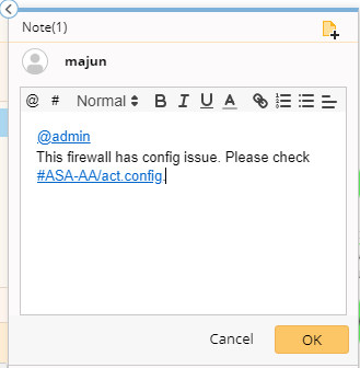

5.(Optional) Click the
icon to add notes to mention other users to further check configurations.
