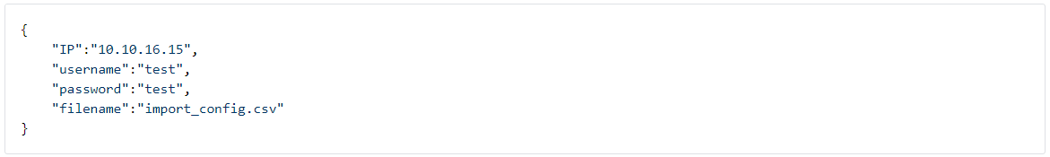

3.In a discovery task, add this plugin and define it as follows:
1)Select Before executing discovery task as the execution point.
2)Define the input. In the Input filed, enter the information to access the FTP server and the name of the CSV/Excel file.
This plugin will be executed when the system runs the discovery task next time.

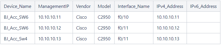

This plugin is used to add end systems to your NetBrain system.
1.In a network shared directory (an FTP server in this case), prepare a CSV/Excel file to populate the information of the end systems that you want to add. The sample format of the CSV file is as follows:
The parameters in the CSV file are described in the table below:
Parameter |
Description |
Device_Name*required |
The name of the end system that you will import. |
ManagementIP*required |
The management IP of the device that you will import. |
Vendor |
The vendor information of the device that you will import. |
Model |
The model of the device that you will import. |
Interface_Name |
The interface name of the device that you will import. |
IPv4_Address |
The interface IPv4 address of the device that you will import. |
IPv6_Address |
The interface IPv6 address of the device that you will import. |

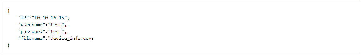

2.In a discovery task, add this plugin and define it as follows:
2)Define the input. In the Input field, enter the information to access the FTP server and the name of the CSV/Excel file.

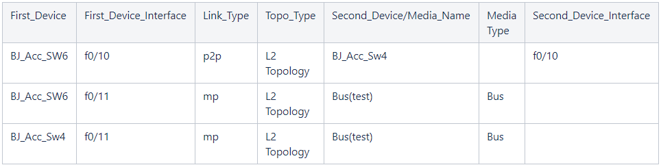

This plugin is used to modify the topology links between device interfaces when the links built by your NetBrain system are inaccurate.
Parameter |
Description |
First_Device*required |
One of the two devices that you want to stitch the topology between them. |
First_Device_Interface*required |
The interface of the device that you will stitch topology. |
Link_Type |
The type of link that you want to add between two device interfaces. There are two link types: ▪p2p: means point-to-point connection. ▪mp: means point-to-multipoint connection. |
Topo_Type |
The topology type of the link between two device interfaces. There are the following topology types:
Second_Device/Media_Name |
The device or media name that the first device connects to. When the link type is mp, this field is required. |
Media Type |
The type of the media, including LAN, BUS, VPLS and L2 Overlay. When the link type is mp, this field is required. |
Second_Device_Interface |
The device interface that the first device interface connects to. When the link type is p2p, this field is required. |

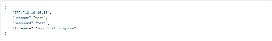

2.In a benchmark task, add this plugin and define it as follows:
1)Select After building L3 topology as the execution point.
This plugin will be executed when the system runs the benchmark task next time.
