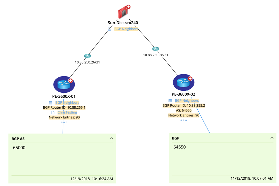

Individual Device Note a note linked to one device. Each qualified device displays its own device note.

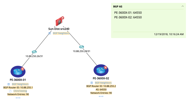

Compound Note (Append) a note linked to multiple devices and its content is merged with the notes of these devices. Each note uses the hostname of the device as its prefix.

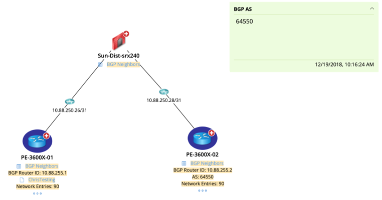

Compound Note (Overwrite) a note linked to multiple devices but its content is the latest note for one device. The previous note will be overwritten by a new one.
