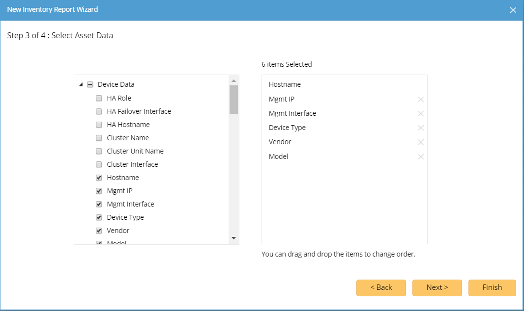

▪For device report, interface report, and module report, select the asset data that you want to include in the inventory report. Click Next.
Tip: To display the customized properties as asset data, you need to configure the controls in the Global Data Repository.

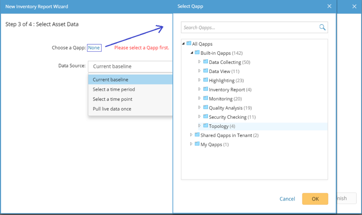

▪For Qapp report, you need to select a Qapp with report output and specify the data source. Click Next.
