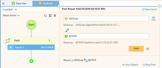

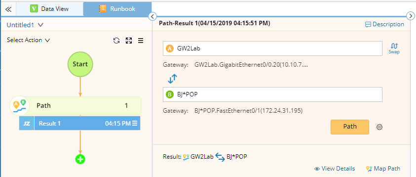

3.Add the Path action node.
1)Click Select Action or the  icon, and then double-click Path.
2)In the Path node, specify two endpoints, and click Path.
Tip: To modify the node name, point to the node and click the  icon to select Rename.
3)After the path is diagrammed on the map, click the  icon to add a note. To mention a device, enter # and further select a device asset. A link will be generated for other users to quickly access the required information.

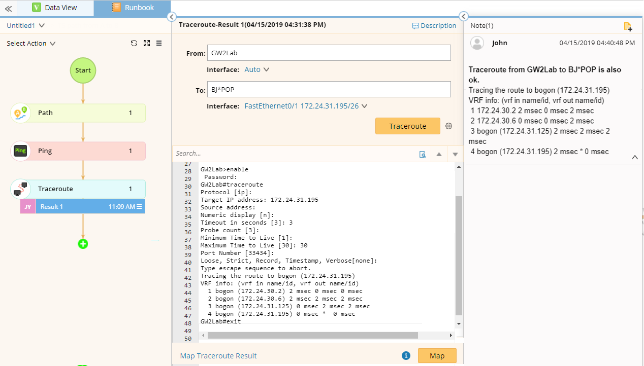

5.Add the Traceroute node and execute the action. Make a note to record the result.

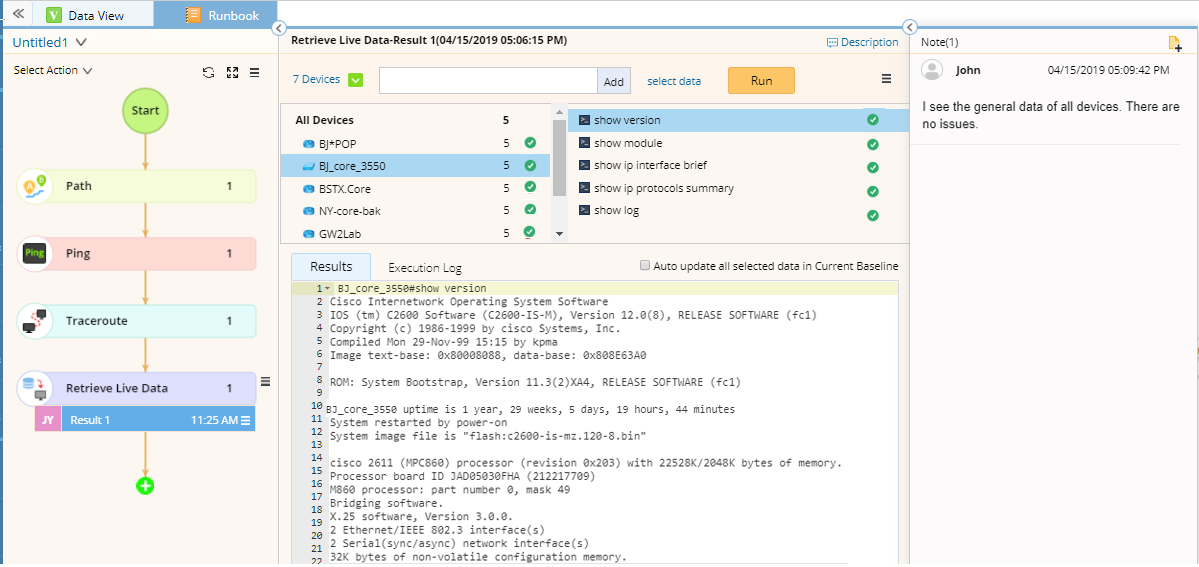

6.Add the Retrieve Live Data node, click the  icon to load CLI commands via template, and then click Run.

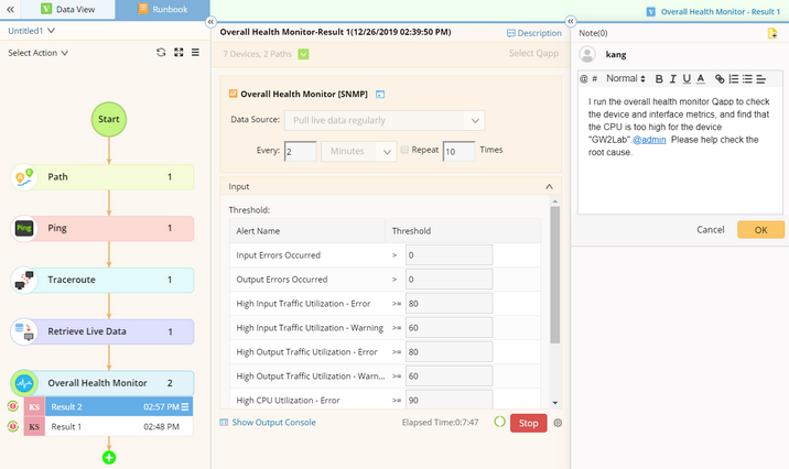

7.Add the Overall Health Monitor node, and then click Run. See Running a Qapp for more reference. After running the Qapp, make a note to describe the issue and enter @ to mention admin for escalation.
