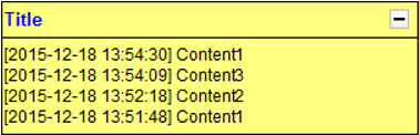

▪Note
Message Level |
Description |
MessageLevel.Information |
Information level. |
MessageLevel.Warning |
Warning level. |
MessageLevel.Error |
Error level. |
MessageLevel.System |
System notification message, generated by the system. |
MessageLevel.PythonError |
System error message, generated by the system. |
Alert Level |
Description |
AlertLevel.Warning |
Warning level. |
AlertLevel.Error |
Error level. |
