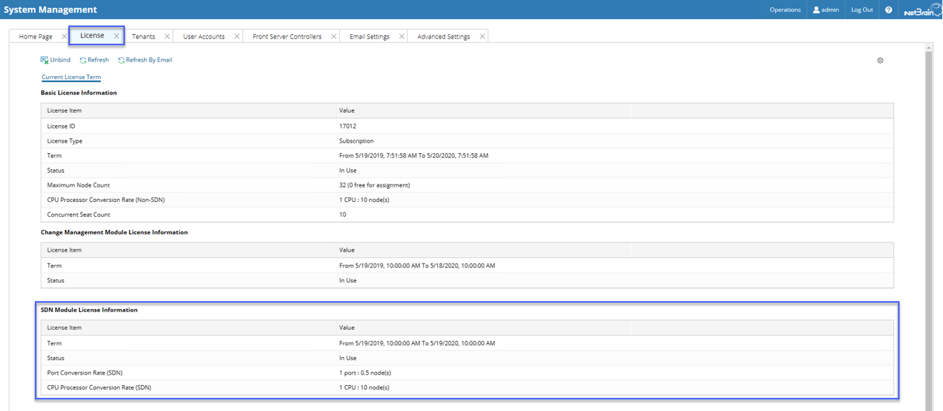

Note: Before continuing with the following steps, make sure your SDN license has been activated. Here is an example:

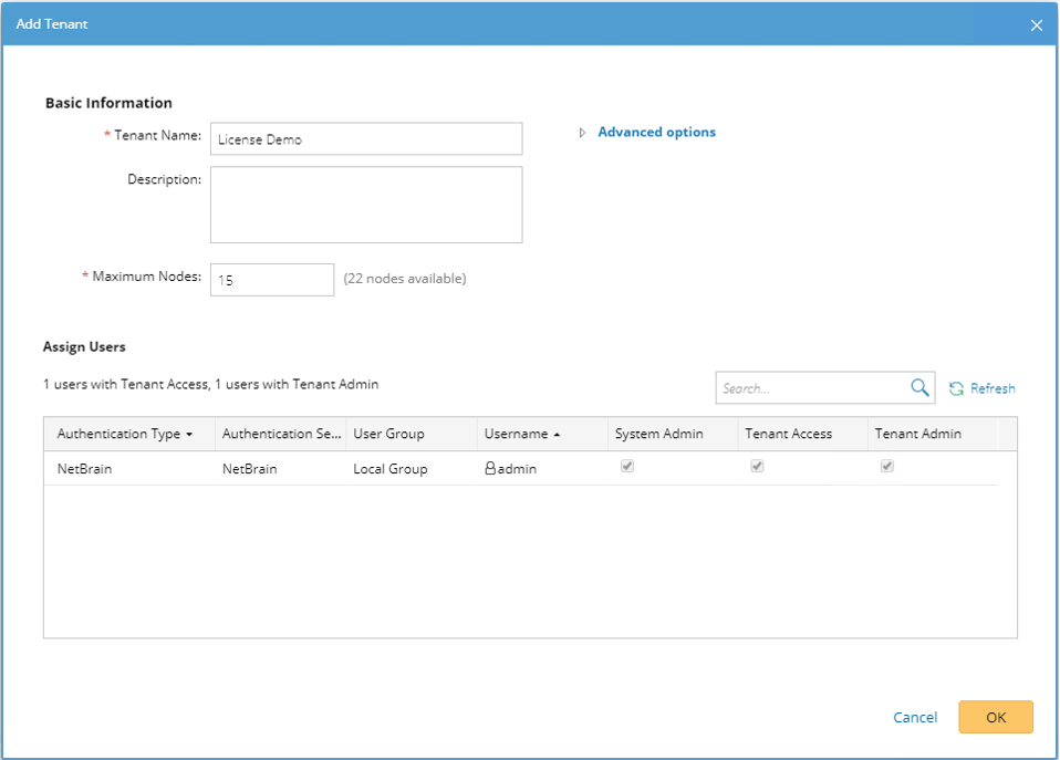

2.Select the Tenants tab, and click Add.
3.Specify a tenant name and allocate a maximum number of nodes to the tenant.
4.Click OK to submit.

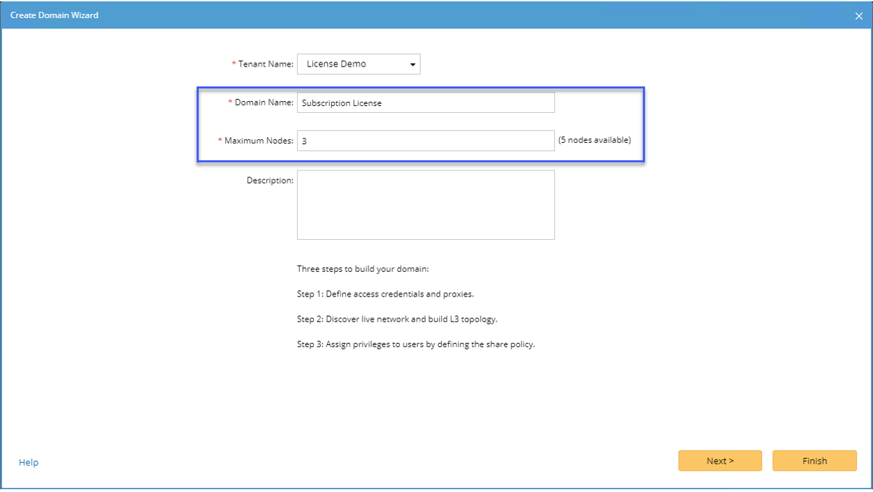

6.Select the tenant you created from the quick access toolbar, and click New Domain.
7.Specify a domain name and allocate a maximum number of nodes to the domain.
8.Click Finish.

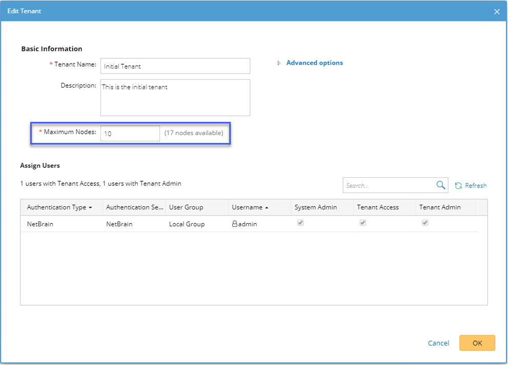

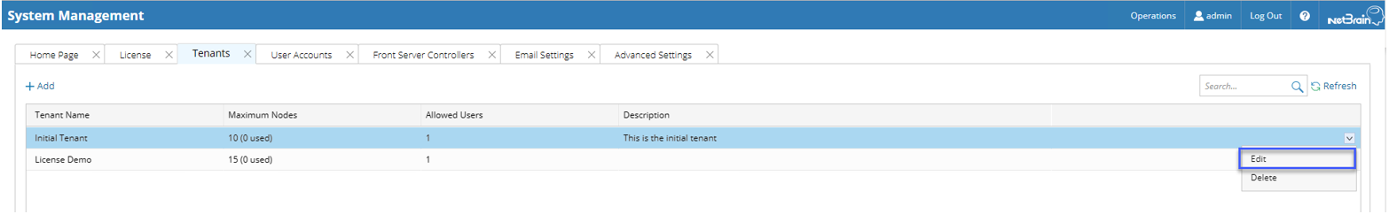

2.Select the Tenants tab, and select Edit from the drop-down list of the desired existing tenant.
3.Allocate a maximum number of nodes to the tenant.

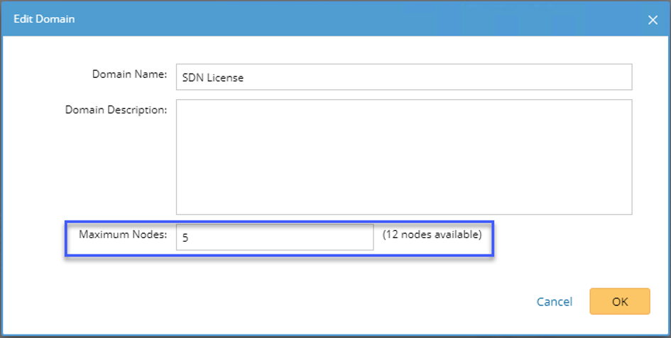

6.Select the existing tenant from the quick access toolbar, and select Edit from the drop-down list of the existing domain.
8.Click OK.
