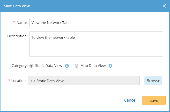

To quickly duplicate data units in a data view for further application, you can save it as a new one. To do so:
1.In the Data View pane, double-click the dynamic data view Network Table Overview to apply it to a map page.
2.Click the icon on the top of the map and click Save As.
1)Enter the data view name and description.
2)Specify the data view category Static Data View.
3)Specify the location. By default, it is under the Static Data View tab.
3.Click Save. Then click OK.
Tip: You can also right-click the blank area on the target map and select Data View > Save As to save the dynamic data view.
