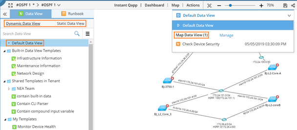

Data views can be categorized into the following types:
▪Dynamic Data View (
or
▪Static Data View (
▪Map Data View (

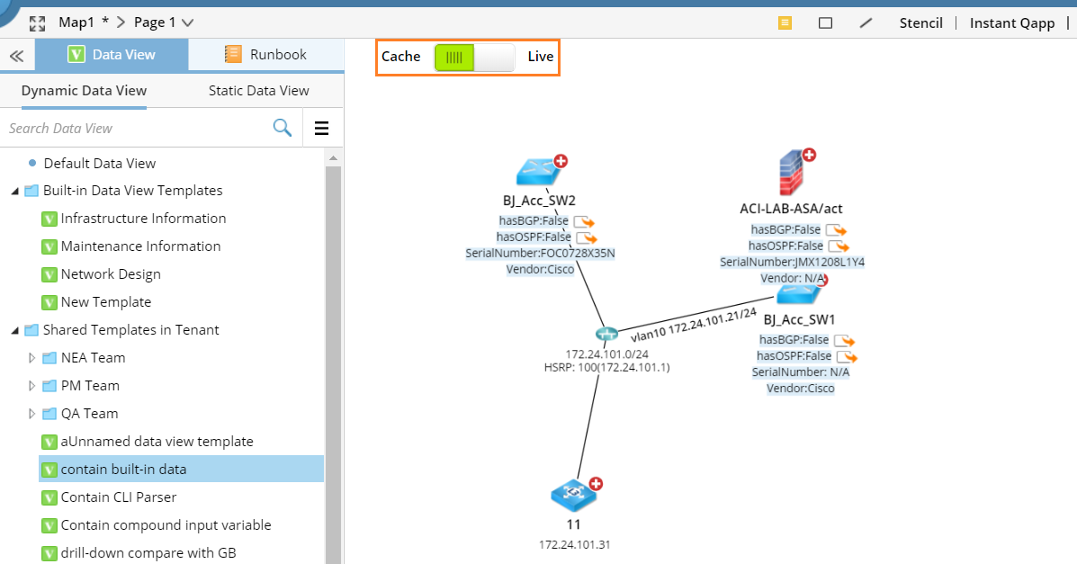

Dynamic Data View refers to those data views generated by applying Data View Templates (DVT) to a map page. See Applying a Dynamic Data View to View Alert and Drill Down for more details.
Tip: The
indicates the data view template has been scheduled to run; the
icon indicates the data view template hasn't been scheduled to run.
Tip: To pull live data in a data view, you can toggle the switch from Cache to Live.

Map Data View refers to a data view that is saved within a map, and can only be visible in the map. It is generated by saving a dynamic/static data view.
To view Map Data Vies, select the Map Data View pane and then click the
icon on the top of the map.
Tip: You can click the
icon to edit the map data view after the data view is applied.
