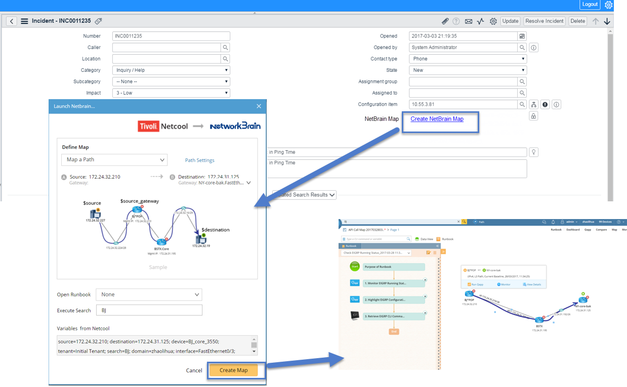

Step 2: Define Pop-up API Stub
1.Click the generated hyperlink, and you will be required to log in to the NetworkBrain system. Then the Pop-up API Stub dialog prompts as follows, with the parameters defined in the scripts populated.
Tip: To have the vendor logo displayed at the upper-right corner, you need to manually add it to the system. See Adding an API Vendor for more details.
2.Select a way to create a map in the Define Map area. By default, the pop-up API stub creates a map as per the definitions in your scripts.
Map Device and its Neighborsdraw the problem device and its neighbors on a map. You need to specify the neighbor interfaces that you want to extend in the third-party system.
Map a Pathdraw the traffic flow from a device to another. For a path, you can also define path parameters, such as data source, and protocol, by clicking the Path Settings hyperlink.
Note: You need to specify the destination and source devices when writing scripts in the third-party system.
Open Site Map of the Deviceopen the site where the problem device locates. To avoid changing the original site data, select the Make a copy of the Site Map checkbox.
Open Existing Mapopen an existing map in your domain.
Open Context Map — open the context map of the problem device. Select a device category (Legacy Device or Cisco ACI Device) for the problem device.
New Empty Mapcreate a map page without any devices on it.
3.In the Open Runbook field, select a runbook to be executed on the map.
Tip: You can predefine your preferred runbooks for a third-party vendor in the System. See Adding an API Vendor for more details.
4.Select whether to search for devices. See Searching for Devices for more details.
5.Click Create Map.
