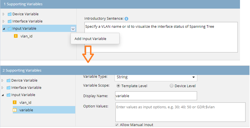

Manually Add an Input Variable
See Properties for more detailed explanation.
Properties of Input Variable
The following table lists the properties of an input variable.
Property
Description
Introductory Sentence
A sentence appearing on user interface to require user input when applying a data view template.
Variable Source
The command of CLI/SNMP parser or name of API parser where this input variable originates from.
Note: This property only applies to those loaded from parameterized parser variables.
Variable Type
The type of this input variable: Boolean, Number, or String.
Variable Scope
The effective scope to use this input variable.
Template Level use the same value for all qualified devices to generate data views.
Device Level use different values for qualified devices to generate data views.
Display Name
The name of this input variable displayed in a prompt dialog to ask for user input.
Option Values
The values that can be selected and used to generate a data view. Multiple values must be separated by a semicolon.
You can correlate option values to a single device-level GDR property. For example, GDR:$vlan. The format is GDR:$<propertyname>.
Note: Table-type variables are not supported.
Allow Manual Input
Control whether values can be manually entered for this input variable at the runtime of data view template.
