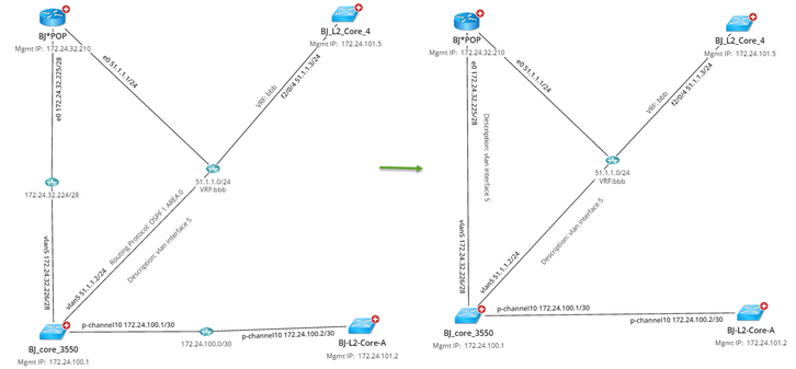

1.On a map, select Map > Map Settings from the map toolbar.
2.Customize the following settings based on your needs. See Map Settings for more explanations.
To adjust the display ratio for a data unit, click the cell to change the value.
To hide a data unit from the map, deselect the check box.
3.To apply this change as default to all your newly created maps, click Set as Default. Otherwise, this change will only be applied to the current map session.

Display Ratio
Indicates the threshold of zoom controls for displaying a corresponding data unit on a map.
Zoom Step
Indicates the zoom controls changed by each zoom-in or zoom-out action. See Browsing Device Data on Map for more details.

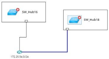

Hide media connected with two topology links only
Hides the media connected with only two links.
