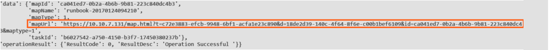

A map URL will be returned in the script output of your third-party system when API task is triggered, and you can visit the map containing the devices with alerts via this URL.
