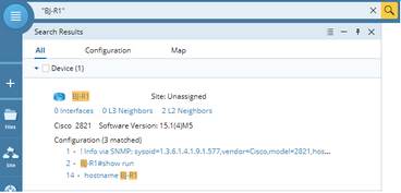

Full-Text Search
Use full-text enclosed with double quotes (" ") to search for an exact phrase.
Tip: The double quotes can be omitted if you want to use an IP address for an exact search.
Example: Search for the device BJ-R1.

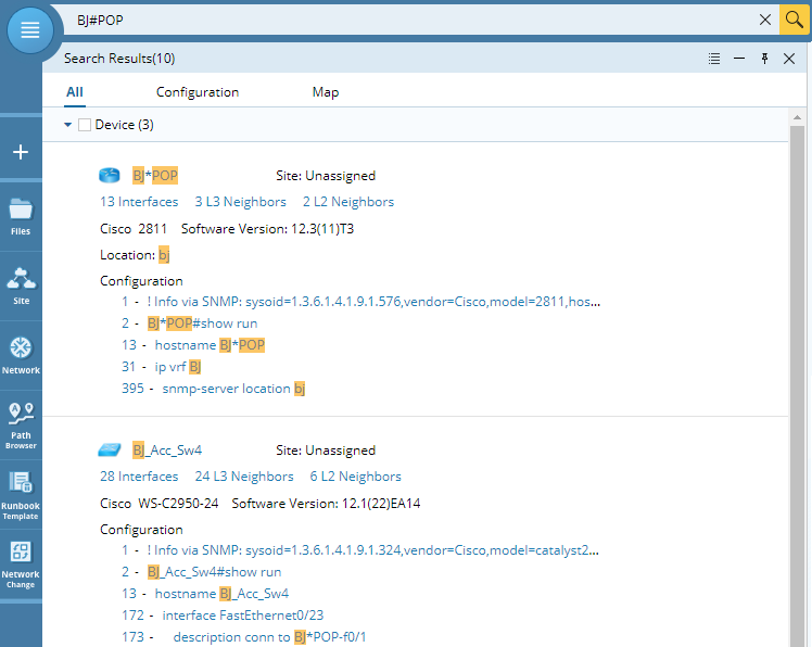

Term Search
Split full text into terms with separators and find objects containing any of the terms.
The following characters are treated as separators:
Note: The * and ? characters are used as wildcards. Only in Advanced Search, they are used as separators.
For example, when you enter BJ#POP as the keyword, it will be split into two terms: BJ and POP. The name of the objects containing either BJ or POP is listed in the search results, with the matched term highlighted.

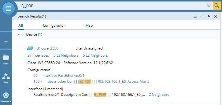

The following characters are not treated as separators:
_ - . / :
For example, when you enter BJ_POP as the keyword, it will not be split into two terms. Only the name of the object exactly matches BJ_POP is listed in the search results.

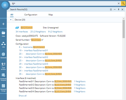

Wildcard Search
Wildcard is a character that can be used as a substitute for any of a class of characters in a search, thereby greatly increasing the flexibility and efficiency of searches.
The following wildcards are supported for a fuzzy search:
Wildcard
Description
Example

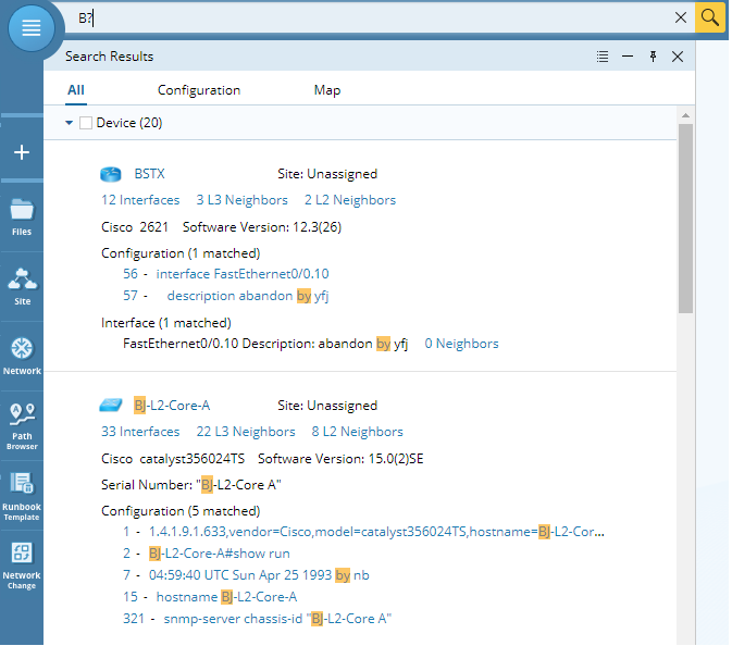

Used to replace zero or more characters.
Used to replace a single character.
Note: It may take a while to return the search results if the search text starts with any wildcard because all terms in the index will be examined.

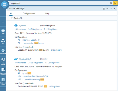

Regex Search
Regular expression (regex for short) is a pattern that denotes a class of alternative strings to match. Regex search supports keywords conducted with a regular expression for a fuzzy search. To make the regex search recognized, you must add the regex: prefix before the regular expression.
Most regular expression engines allow you to match any part of a string. If you want the pattern to start at the beginning of the string or finish at the end of the string, then you have to anchor it specifically, by using ^ to indicate the beginning or $ to indicate the end.
Note: When $ is used at the end of a string with multiple terms, then it represents an exact match.
The following characters are allowed in regex search.
Character
Description
Example

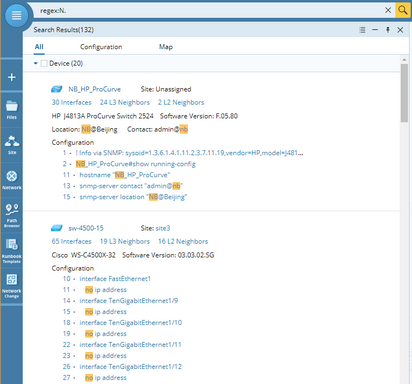

Match any character
Used to represent any characters.
Zero-or-one
Used to make the preceding shortest pattern optional. It matches zero or one time.

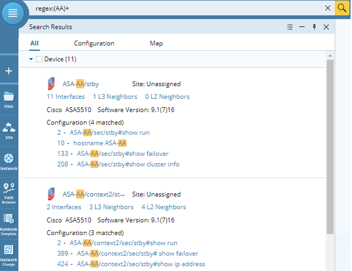

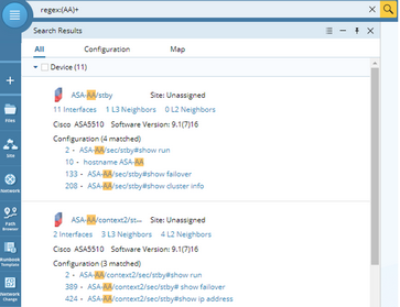

One-or-more
Used to repeat the preceding shortest pattern once or more times.
Zero-or-more
Used to match the preceding shortest pattern zero-or-more times.

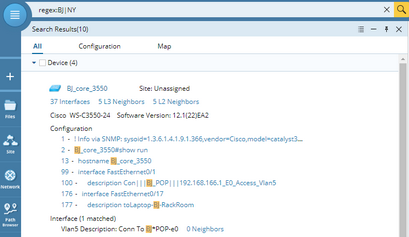

Alternation
Used as an OR operator. It matches the pattern on either the left side or the right side.

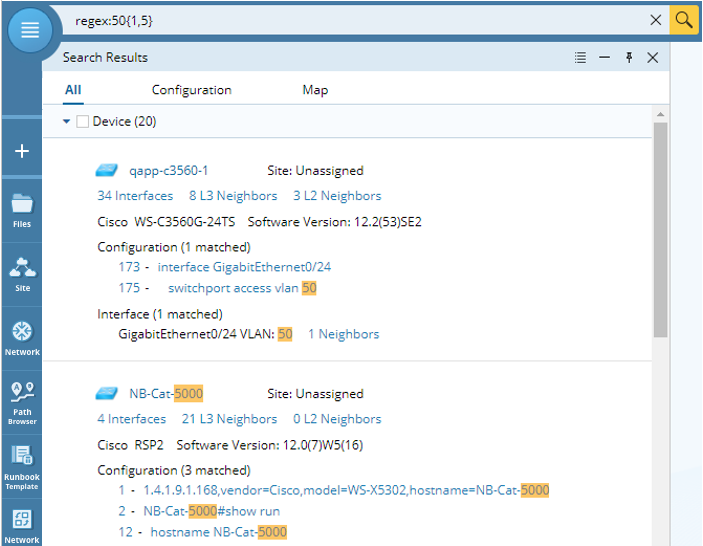

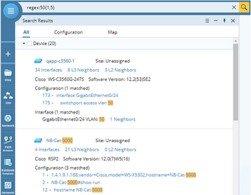

Min-to-max
Used to specify a minimum and a maximum (optionally) number of times that the preceding shortest pattern can repeat.

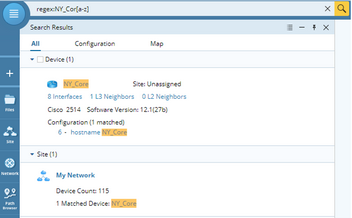

Character classes
Used to enclose ranges of potential characters as character classes.
Note: The dash character (-) indicates a range of characters, unless it is the first character.
Grouping
Used to group all characters listed above to form sub-patterns.
