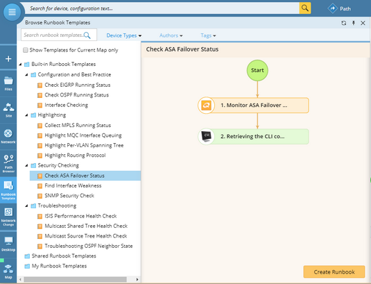

1.On a map with Cisco ASA firewalls, click Runbook Template on the taskbar.
2.In the runbook template tree, select Security Checking > Check ASA Failover Status, and click Create Runbook.
Tip: You can select Show Runbooks for Current Map only check box to filter runbooks based on device types included on the map.

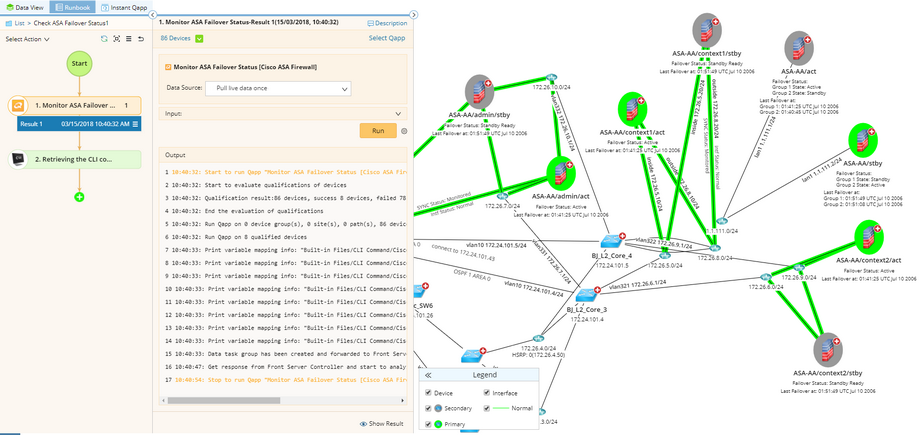

3.In the Monitor ASA Failover Status Qapp node, add target devices, select Pull live data once and click Run. The active and standby status of ASA firewalls is displayed on the map. According to the legend, the ASA-AA/act firewall becomes secondary but the ASA-AA/stby firewall becomes primary.

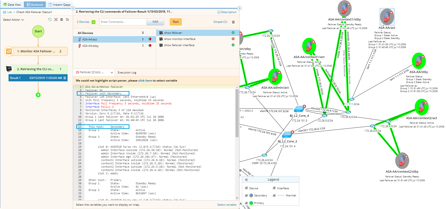

4.In the Retrieving CLI commands node, select ASA-AA/act and ASA-AA/stby as target devices, and click Run. From the output result, the status issue is verified.

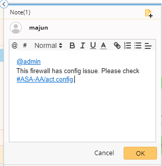

5.(Optional) At upper-right corner of the runbook, click the icon to add notes to mention other users to further check configurations.
