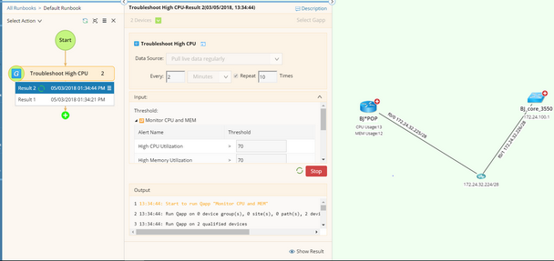

Example: Run the Troubleshoot High CPU Gapp from a map.
1.On a map, select Run Gapp from the right-click menu, or select Actions > Run Gapp from the map toolbar.
2.In the Select Gapp dialog, select the Troubleshoot High CPU Gapp, and click OK.
3.Before running the Gapp, you can select to configure the following settings:
1)Click the
icon to customize target devices. By default, all devices on the current map are auto-populated.
2)Click the Data Source field to select Pull Live data regularly for this Gapp. Then define the frequency.
3)Customize Gapp input, including threshold values of variables.
4)To share alerts with specific users, or configure message levels, click the
icon. See Sending Alerts for more details.
4.Click Run and view the result. The Qapps inside the Gapp will be executed in sequence, and the triggered alerts will be displayed in the Alert Console.

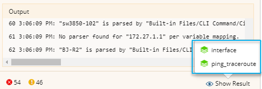

Tip: If the Gapp generates multiple data views, you can click Show Result and further select the target one.
