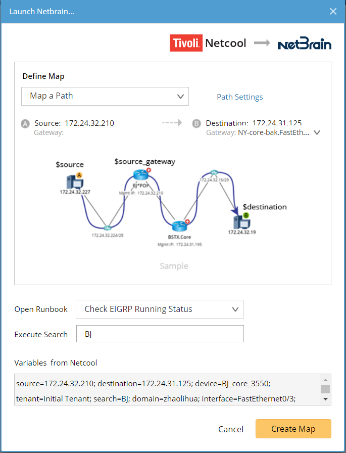

1.Click the generated hyperlink, and you will be required to log into NetBrain system. Then the Pop-up API Stub dialog will prompt as follows, with the parameters defined in the scripts populated.

2.Select a way to create a map in the Define Map area. By default, the pop-up API stub creates a map as per the definitions in your scripts.
▪Map Device and its Neighbors — draw the problem device and its neighbors on a map. You need to specify the neighbor interfaces that you want to extend in the third-party system.
▪Map a Path — draw the traffic flow from a device to another. For a path, you can also define path parameters, such as data source, and protocol, by clicking the Path Settings hyperlink.
Note: You need to specify the destination and source devices when writing scripts in the third-party system.
▪Open Site Map of the Device — open the site where the problem device locates. To avoid changing the original site data, select the Make a copy of the Site Map check box.
▪Open Existing Map — open an existing map in your domain.
▪New Empty Map — create a map page without any devices on it.
3.In the Open Runbook field, select a runbook to be executed on the map.
Tip: You can predefine your preferred runbooks for a third-party vendor in the System. See Adding an API Vendor for more details.
4.Select whether to search for devices. See Searching for Devices for more details.
