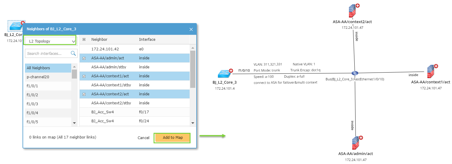

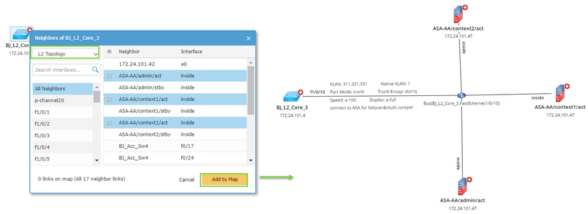

3.Click the icon attached to the device to extend layer 2 neighbors as follows.
Tip: The bus icon is a medium used to simulate a layer 2 port on a map when the port is connected with more than 2 ports or devices.

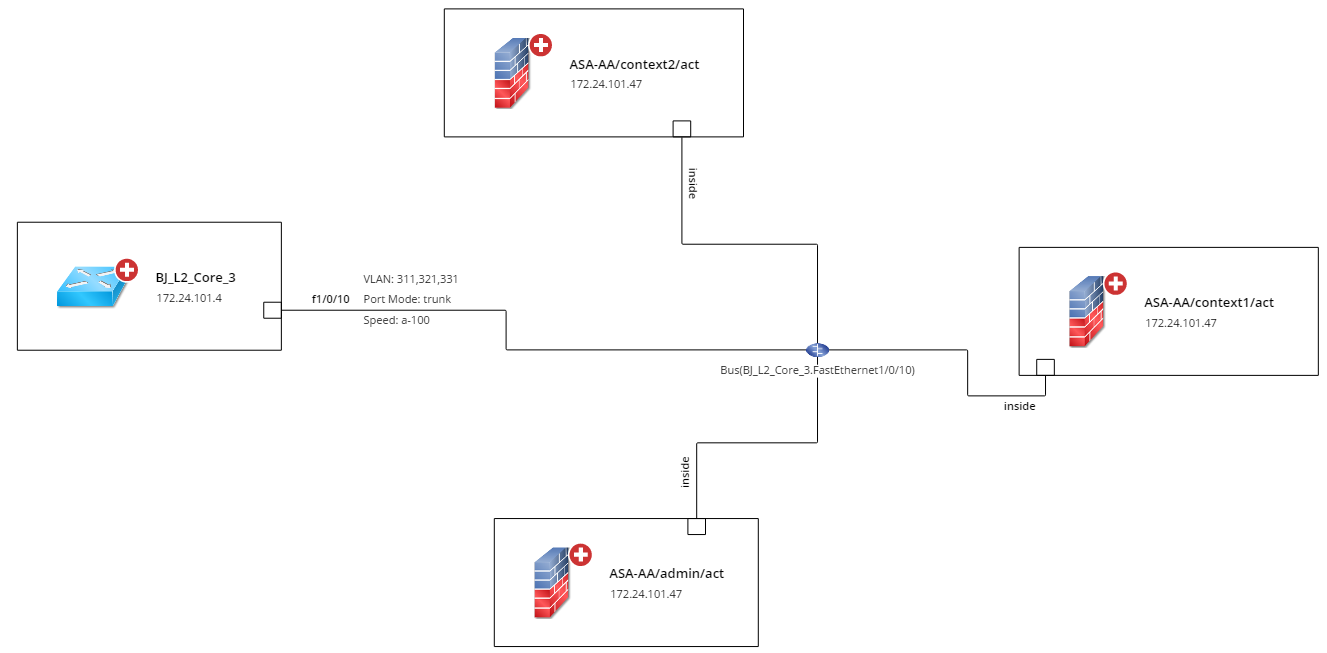

4.To view the port-to-port connectivity among the devices, right-click on any blank area of the map and then select Change Device Style > Expanded Style.
Tip: You can rotate the wheel button of your mouse forward to zoom in on the map to view more detailed information.
