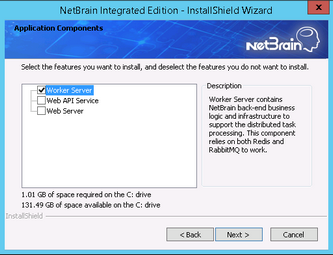

7)Select the Worker Server check box, and then click Next.

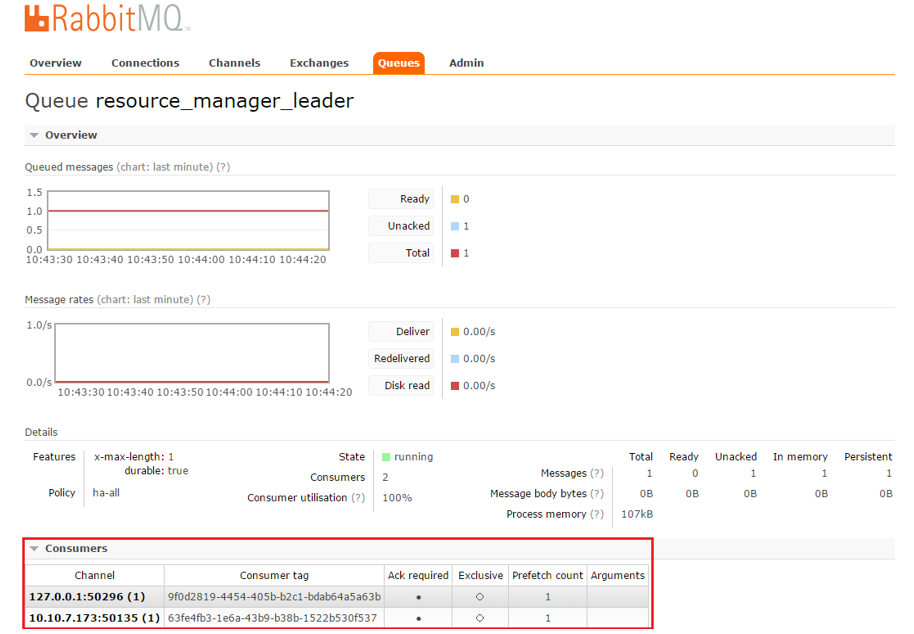

After deploying Worker Server cluster, you can log in to the RabbitMQ Management page to browse server nodes.
1.In your web browser, navigate to http(s)://<IP address of Message Server>:port_number. For example, http://10.10.7.171:15672 (the default port number for the RabbitMQ Management Plugin).
2.Enter the username and password that you created when installing the Message Server, and then click Login.

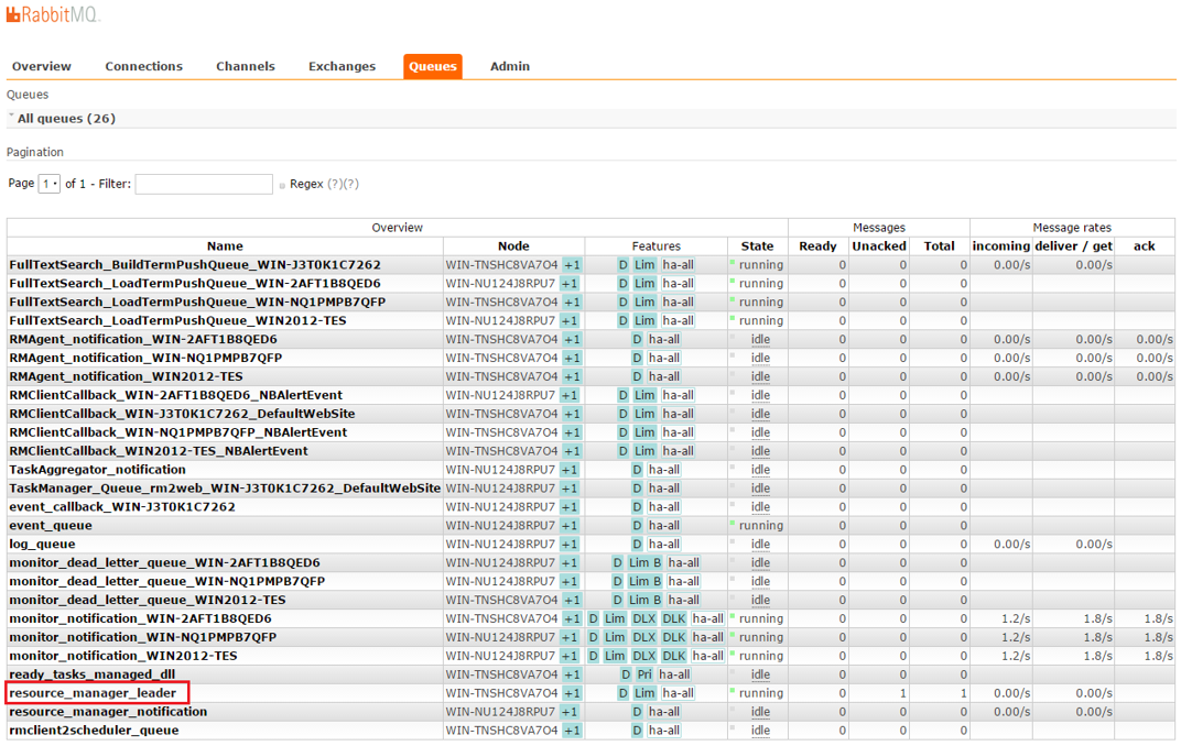

3.Select Queues > resource_manager_leader.
4.Click Consumers. You can see two Worker Server nodes are consuming the RabbitMQ resources.
