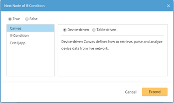

2.Click the
icon on the If-condition node. The following dialog prompts.
3.Select a node for True and select another one for False individually. Click Extend.
This is a sample workflow:

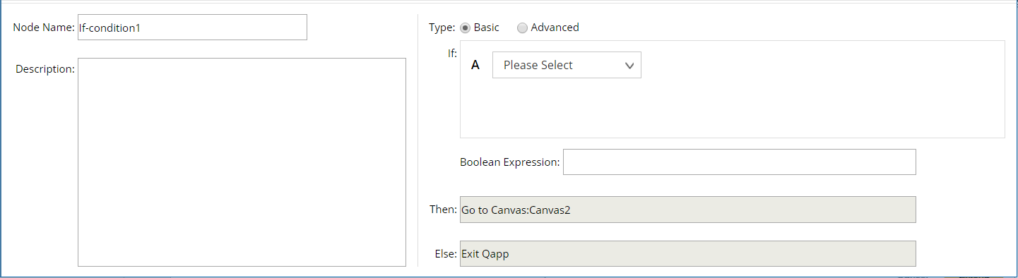

4.Click the IF node in the workflow to configure the detailed settings.
1)Enter the name and a description of the node.
2)Specify the statement type to set the conditions:
▪Basic — select the variables of table attributes from the drop-down list and set conditions.
Note: Only applicable to the Canvas node which has attributes in the Global Data Table nodes.
▪Advanced — enter the script manually. See Python scripting for reference.
