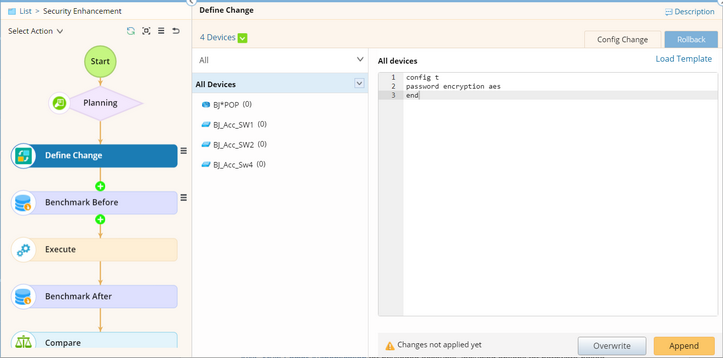

The Define Change node is to define the target devices and commands that will be pushed to the target devices.
1.Select the Define Change node in the runbook.
2.In the Define Change pane, define the following settings:
1)Click the
icon to select the target devices. By default, all devices on the map will be selected.
Tip: Point to a device and click the
icon to select more options.
2)In the Config Change tab, enter the commands that you want to execute on the target devices.
Example: Enter the commands to encrypt a password.
config t
password encryption aes
end
Tip: You can click Load Template and select a predefined configuration template. To create a new configuration template, see Managing Configuration Templates for details.
3)Select All Devices and click Append to add the command to all devices.
Tip: To clear the applied change command to all devices, select All Devices and click Overwrite.
4)(Optional) To cancel a specific change, click the Rollback tab and enter the rollback commands.
