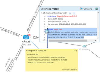

Device note can be used to record and share network design, issues, troubleshooting, and other network knowledge. You can add device notes with network design or create a blank note to annotate.
To add a device note with network design:
1.On a map, open the Design Reader for the data unit that you are interested in.
2.Select several lines in the configurations and click the icon to create a device note with the selected content.
Tip: You can directly click the icon to create a note with the whole content in the design reader.
3.To create notes for more configurations, click Full Config in the design reader and repeat the previous step.
Tip: To merge multiple notes, select the notes, right-click the blank area, and then select Merge to One Note from the drop-down menu.
Tip: You can also right-click a device and select Create Note from the drop-down menu. A blank note is created. And you can enter some content according to your need.
