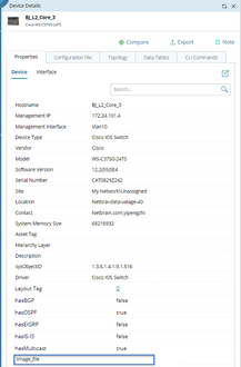

To customize a device/interface/module property, for instance, add the Image File field as a device property for all Cisco IOS switches as follows, you must add the property in GDR.

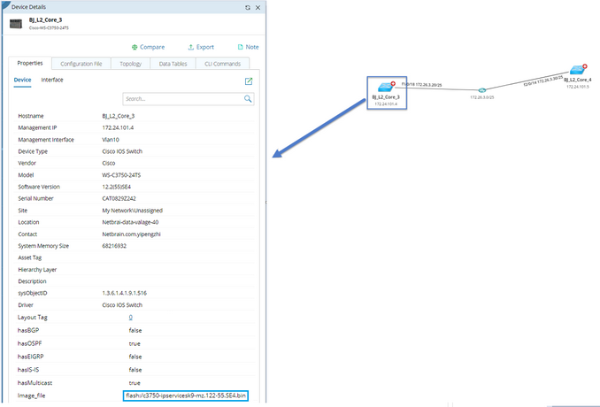

12. Save and run the Qapp on a map with Cisco IOS switches included. Once the Qapp execution is finished, double-click a device to view whether the Image_file field is populated in the Device Details pane.
