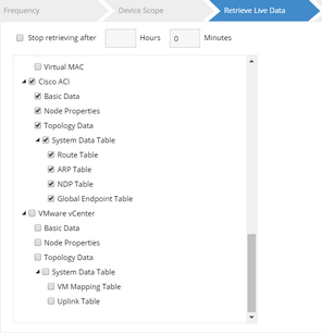

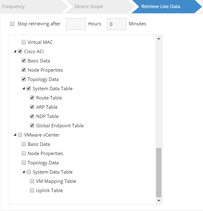

6.Click Retrieve Live Data tab, and check the Cisco ACI checkbox.
