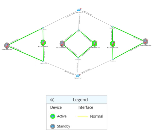

Problem-Based Monitoring on Core Devices or Traffic Paths
For example, application outage previously occurred because the interfaces on active/standby firewall were both down. Schedule a Qapp “Monitor ASA Failover status” to continuously monitor the core application path. When the interface on the active firewall is down again, the path will change; if the interface on the standby firewall is down either, the path will fail. No matter what the situation is, alerts can be pushed to engineers. With the context of root-cause analysis, engineers can quickly fix the issue to avoid the same accident.

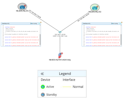

Best Practice Enforcement for Compliance/Security Check
Configuration standards are always required to be followed in one organization, but either compliance check or security check is tedious and time-consuming. With this function, all the checks can be scheduled and automatically executed regularly to verify whether network devices meet certain standards across the board, and a report will be generated to list all devices that failed to comply. For example, core switches configured with HSRP usually have redundancy (active/standby) to prevent single-point-of-failure. Schedule a Qapp to regularly check whether the standby switch has been configured with the same ACL as the active switch does.
