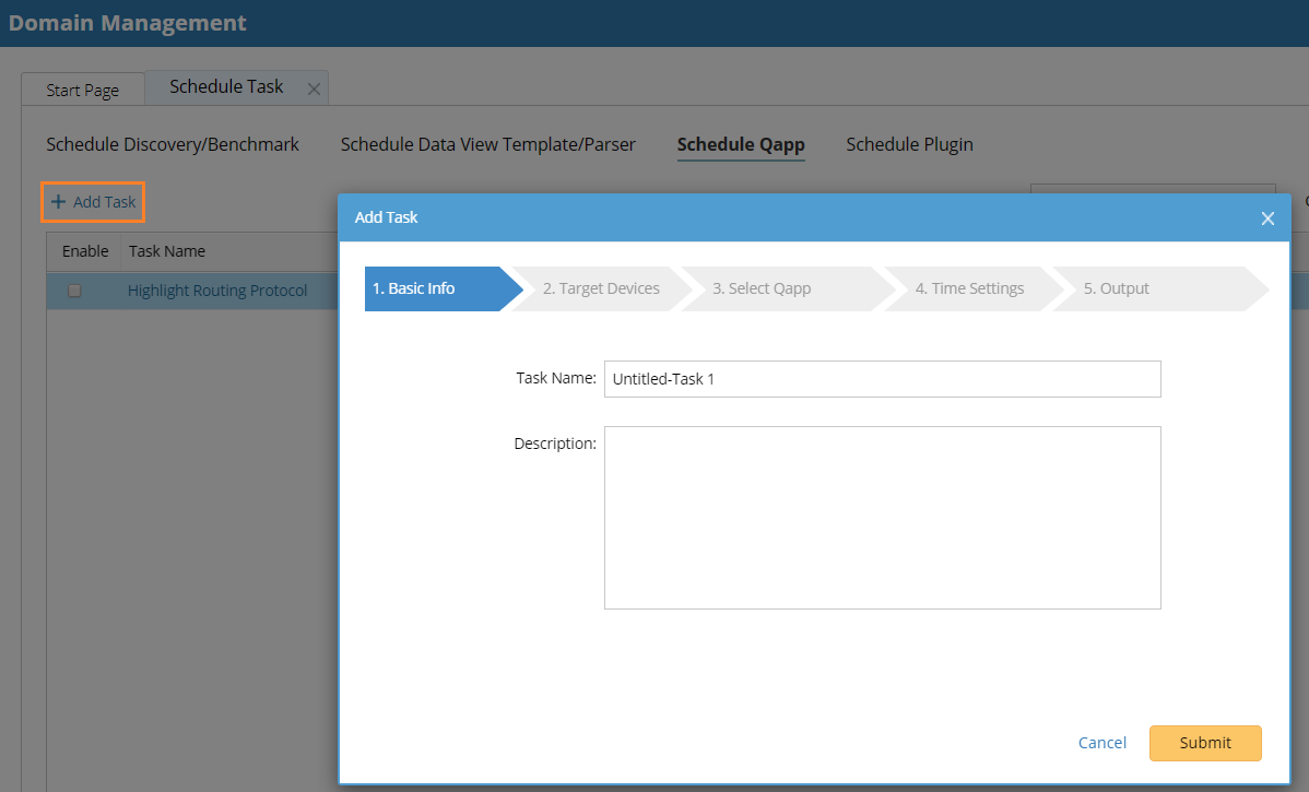

2.In the Domain Management page, click Schedule Task on the Start Page or select Operations > Schedule Task from the quick access toolbar.
3.On the Schedule Qapp tab, click Add Task.

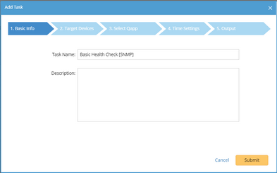

4.Follow the wizard to configure the Qapp task.

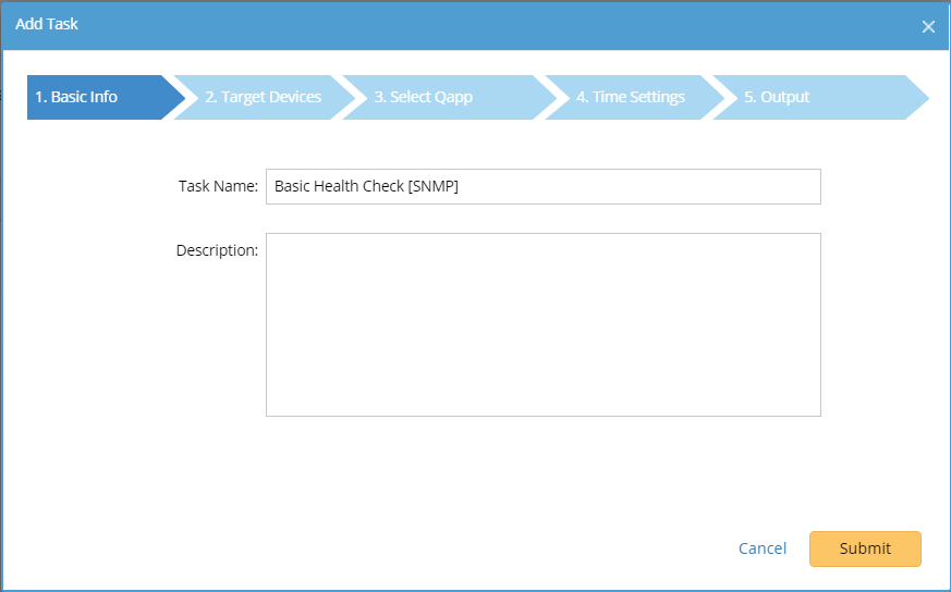

1)On the Basic Info tab, enter the task name Basic Health Check [SNMP].

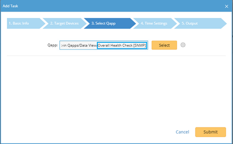

3)On the Select Qapp tab, click Select and choose the Overall Health Check [SNMP] Qapp, then click OK.

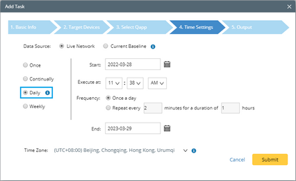

4)On the Time Settings tab, set the data source, execution time and frequency. In this case, set the frequency to Daily.
Note: For the data source, if you select the Current Baseline, you should make sure there is historical data.
Note: The time zone settings refer to the time zone of NetBrain Web Server.
