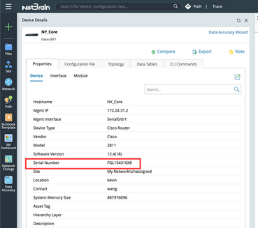

Example:
To see if the serial number is filled in after the Open Driver is executed:
1.Navigate to the device's Device Details Pane.
2. On Properties tab, click Device, and view the Serial Number.
3.Open Data Accuracy Wizard, click Re-validate.
4.No errors are generated. The serial number issue is fixed.
Note:The error will be cleaned automatically after the next scheduled platform validation task execution.
