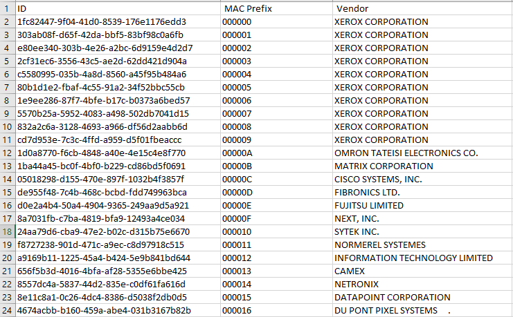

The first 24-bit number of a MAC address is the OUI (organizationally unique identifier) that uniquely identifies a vendor. The system uses the OUI information to identify the vendors of MAC addresses displayed in an ARP table or MAC table.
1.Log in to the Tenant Management page.
2.In the Tenant Management page, select Operations > Misc Configuration. The OUI Information is displayed on the Misc Configuration tab.
3.Perform the following operations based on your needs.
1)Click Add. 2)In the Add OUI Information dialog, enter the MAC prefix and vendor name, and then click OK. |
Click Export to export the OUI information. Tip: The default location of the exported file is C:\Users\<your username>\Downloads. |
