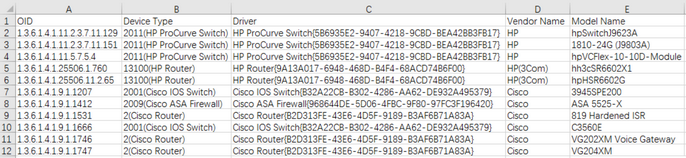

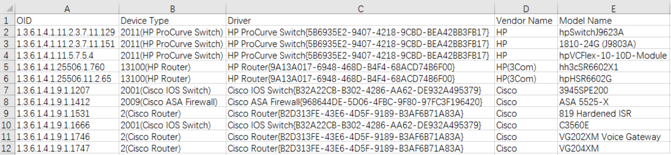

1)Create a .csv file in your local folder. For example: 2)Click Import at the upper-left corner of the table. 3)Select the .csv file you create and click Open. |
