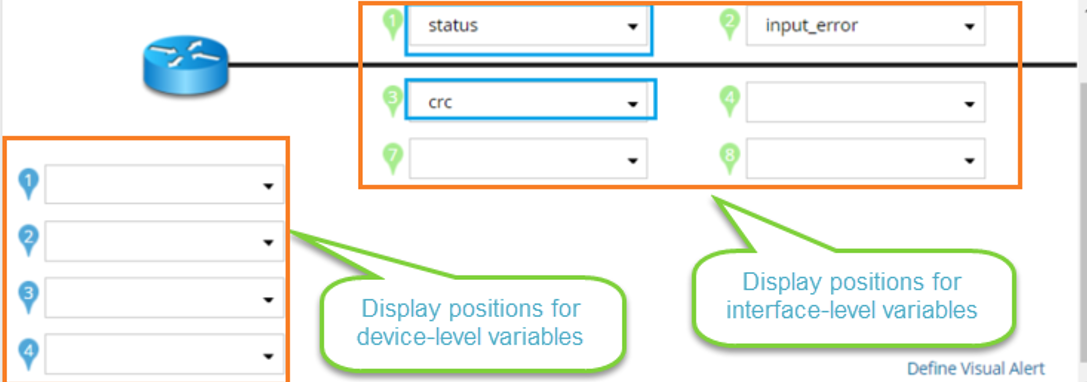

4.Specify the display positions for each variable on a map.

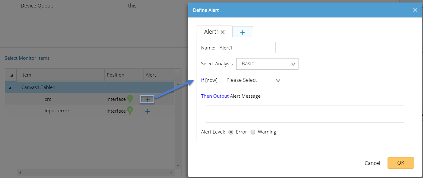

Example: Define an alert condition for the variable $input_error (interface input error).
1)Click the icon to define an alert condition for $input_error.
 2)Select the analysis type to set conditions. The alert will be triggered as soon as the conditions are met.
Basic is the most frequently used method to compare the real-time data with the pre-defined threshold.
For example, to trigger an alert when there is any interface input error.
a)Select > from the drop-down list. [now] means the value of the current poll cycle, > means larger than, and [Threshold] means the limit value to trigger the alert. b)Enter a value in the threshold field. For example, enter 0. When the value of $input_error exceeds 0, the alert will be triggered.

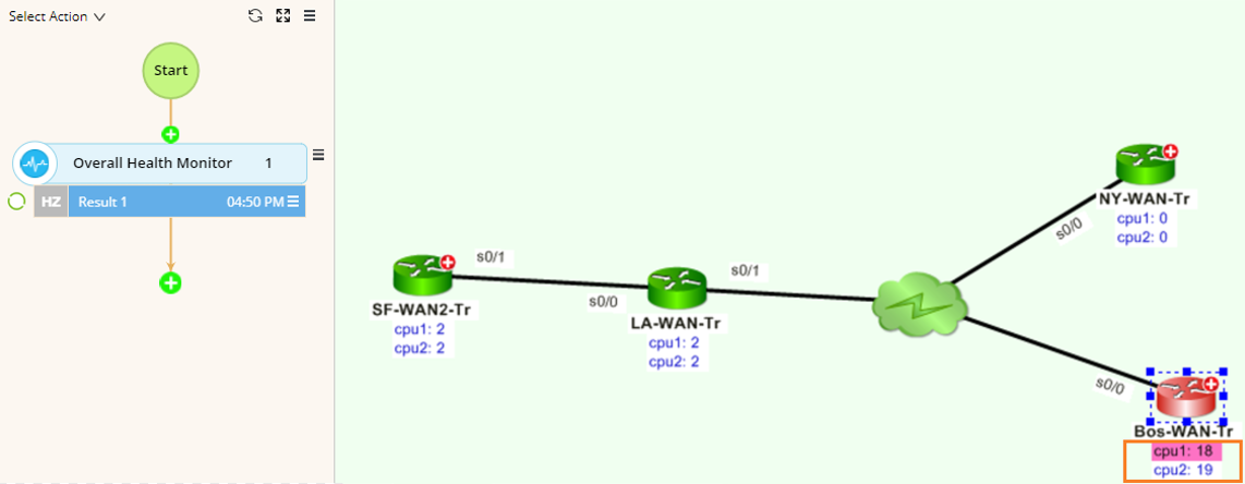

3)Select the alert level. The difference between the two levels is only in the color and text display. |
The visual alert refers to highlight devices or interfaces on the map when the specific alert of monitoring items triggers.

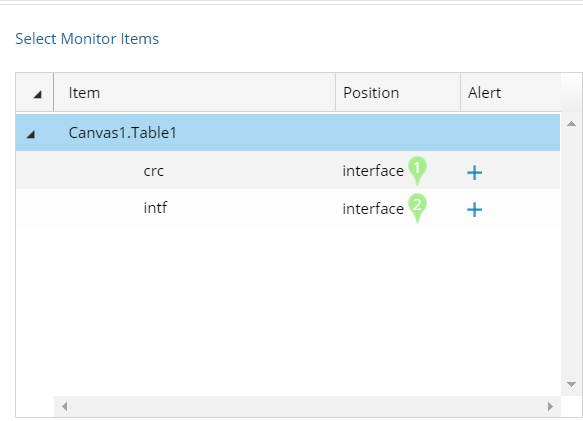

1)Click Define Visual Alert and the following dialog prompts. The monitor items defined with alerts in step 4 are listed here.
 2)Specify which variable change will cause the device or interface color change. You can select multiple variables. 3)If you want to set complex conditions to involve multiple variables, you can click New Compound Alert to define Compound Alert. a)Specify the Compound Alert type between Device and Interface. b)Set conditions for variables. See Defining Alert for more details. c)Enter the alert messages and select the alert level. d)Click OK. 4)Repeat step 3) to add more Compound Alerts. 5)Click OK. 6)Select a position for compound alerts on a map. |

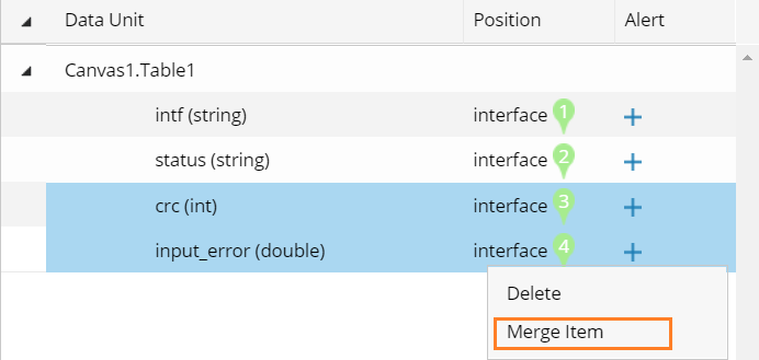

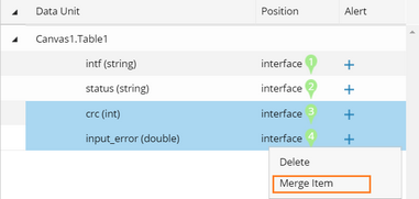

To utilize positions on the map more efficiently, you can merge monitor items within one category (device items or interface items).
1)Press the Shift or Ctrl key on your keyboard to select multiple monitor items and click the icon to select Merge Items from the drop-down menu.
 2)Enter a new name for the newly merged items and click OK. 3)Select one position for the merged items.
