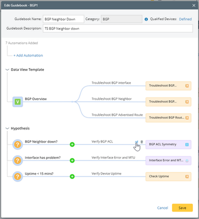

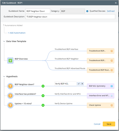

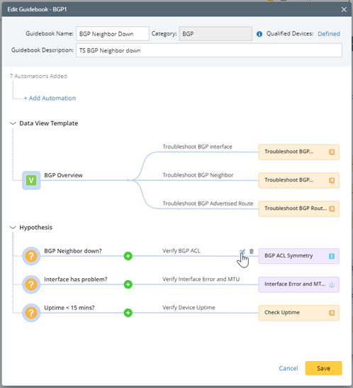

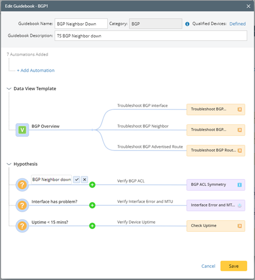

Edit Hypothesis

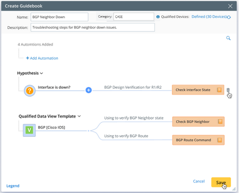

1. In Create Guidebook or Edit Guidebook interface, mouse over a Hypothesis.
2.Click , then you can inline modify the Hypothesis.

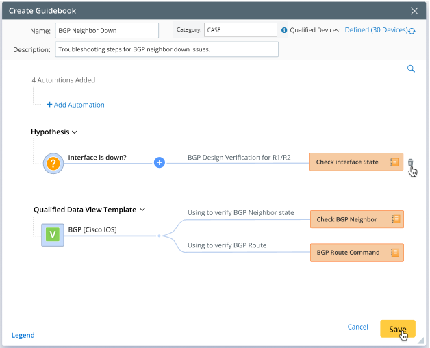

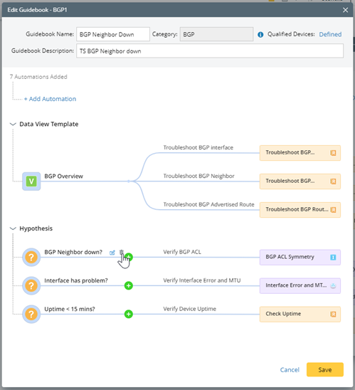

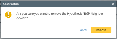

Remove Hypothesis
1.In Create Guidebook or Edit Guidebook interface, mouse over a Hypothesis and click .
2.Click Remove in the Warning window.
Note:The Hypothesis and its associated Runbook Template/Network Intent will be deleted from this Guidebook.

1.In Create Guidebook or Edit Guidebook interface, mouse over the note and click .
2.Inline edit the note.

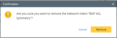

Remove Runbook Template, Network Intent and Network Intent Cluster
The Runbook Template, Network Intent and Network Intent Cluster associated with Hypothesis can be removed from a Guidebook.
1.In Create Guidebook or Edit Guidebook interface, mouse over a Runbook Template/Network Intent/Network Intent Cluster, and click .
2.Click Remove in the Warning pop-up window. The Runbook Template, Network Intent or Network Intent Cluster will be removed from this Guidebook.

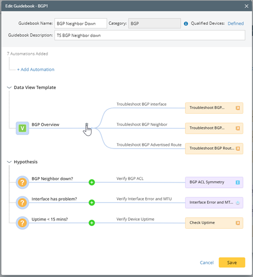

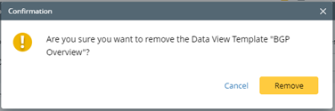

Remove Data View Template
1.In Create Guidebook or Edit Guidebook interface, mouse over the Data View Template, and click .
Note: The Data View Template and its respective Runbook Template/Network Intent will be deleted from this Guidebook.

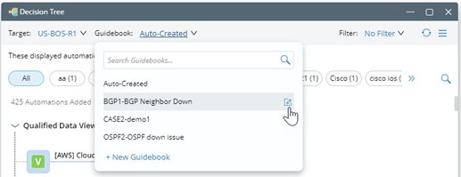

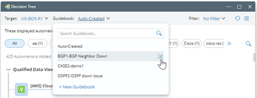

Modify Guidebook
1.In Decision Tree interface, click the current Guidebook.
2.In the select Guidebook drop-down list, hover over the intended Guidebook and click .
