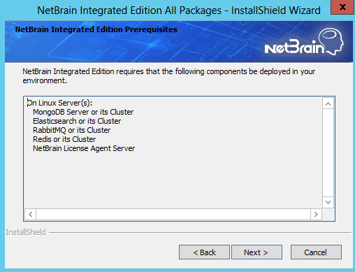

3)On the NetBrain Integrated Edition Prerequisites page, read the list of Linux components that must be deployed beforehand in your environment and click Next.

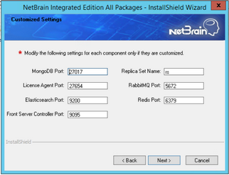

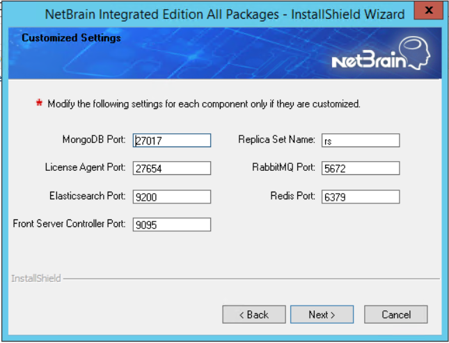

9)(Required only if the Use Customized Ports check box is selected) On the Customized Settings page, you can customize the ports of Linux Components and customize the port for Front Server Controller if you don't want to use the default port 9095. Click Next.

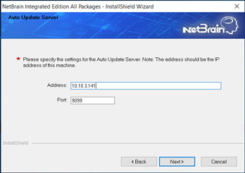

10) On the Auto Update Server, enter the information for Auto Update Server and click Next.
Note: The Address must be the local server’s IP address which can be reached from other NetBrain servers including Front Server.

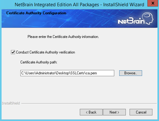

a)On the Certificate Authority Configuration page, to validate the Certificate Authority (CA) of the SSL certificates used on NetBrain Database Server, select the Conduct Certificate Authority verification check box (optional) and click Browse to upload the chain certificate file. Click Next.

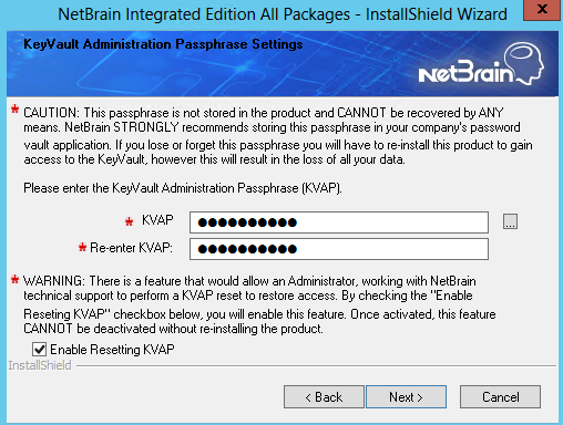

13) On the KeyVault Administration Passphrase Settings page, create a passphrase to initialize and manage the system KeyVault which contains all encryption keys to protect data security. Type it twice and click Next.
Tip: The passphrase must contain at least one uppercase letter, one lowercase letter, one number, and one special character, and the minimum permissible length is 8 characters. All special characters except for the quotation mark (") are allowed.
Note: Keep notes of the passphrase because it is required when you scale up or upgrade the Application Server. In case of losing the passphrase, select the Enable Resetting KVAP check box so that NetBrain system administrator can reset the passphrase at any time.
