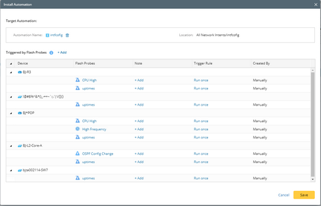

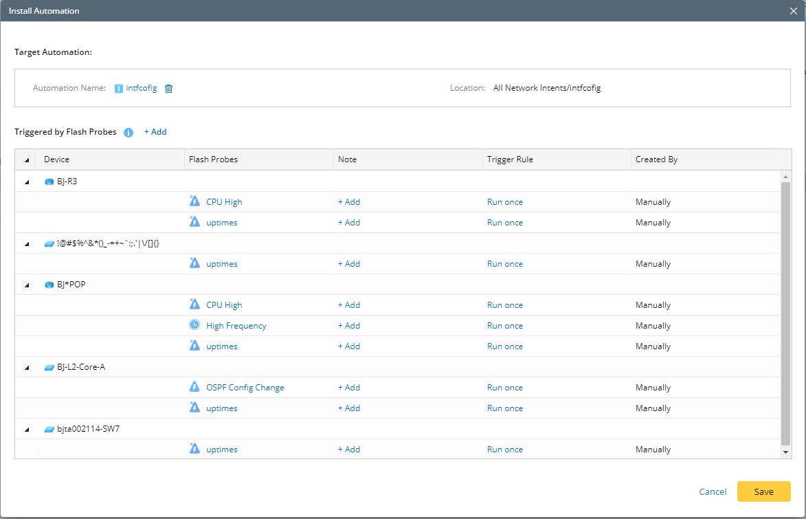

2.Navigate to Probe Triggered Intent tab of Preventive Automation Manager.

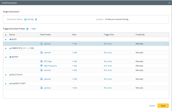

3.Click + Install Intent to start installing a triggered automation for one or multiple devices.

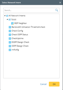

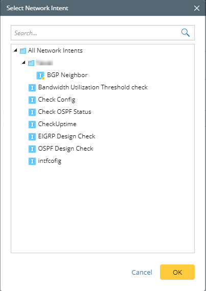

1)Click+ Add Automation.
2)Select the desired Network Intent, click OK.

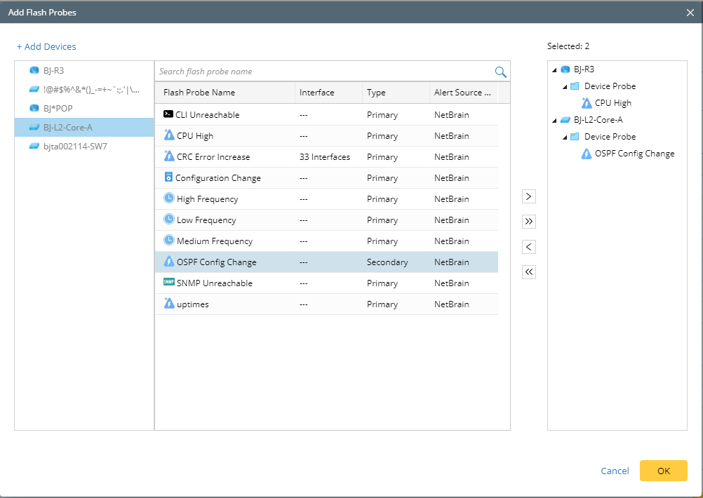

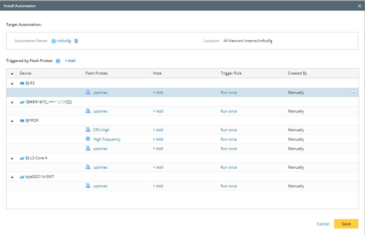

3)After selecting the Network Intent, select a Flash Probe to create a relationship.
a.Click +Add to add a flash probe
b.Select the desired Flash Probe and click to add it to the selected list. You can click to deselect it. To add all the Flash Probes for the device, click .To remove all Flash Probes from the selected list, simply click.
Note: In Add Flash Probes window, all the Flash Probes (of the current device) that belong to the selected Network Intent will be selected by default.
c.Click +Add Devices to select flash probe for other devices.
d.After the desired Flash Probes are selected, click OK to associate the Flash Probes with the selected Network Intent.
Note: Manually in the Created By column is intended to distinguish the Flash Probes from those created by Feature Intent Template.

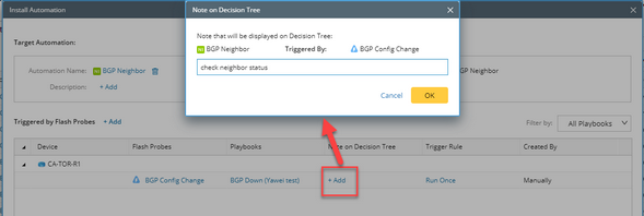

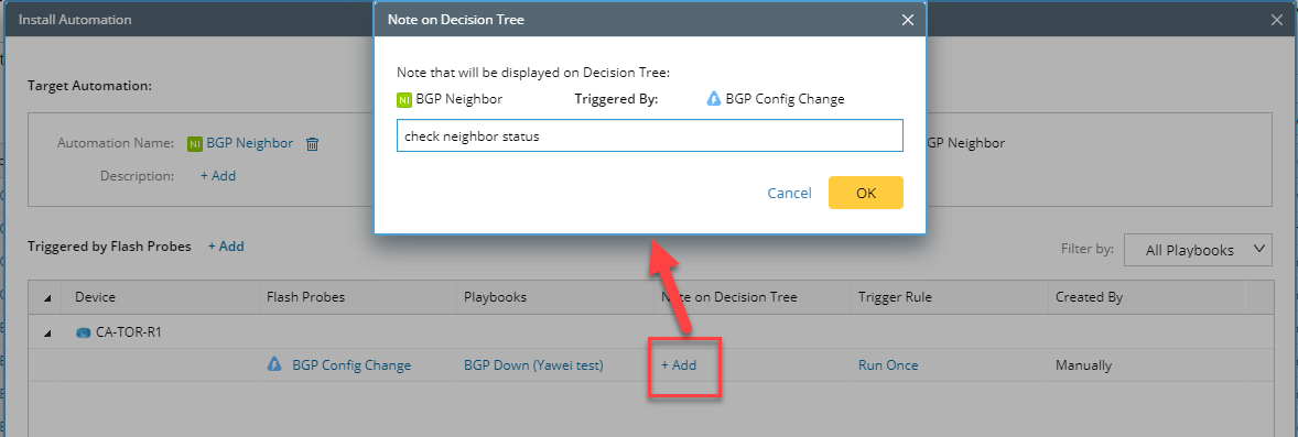

4.Define notes.
1)In the Note column, click +Add.
2)Enter notes in the pop-up window and click OK.

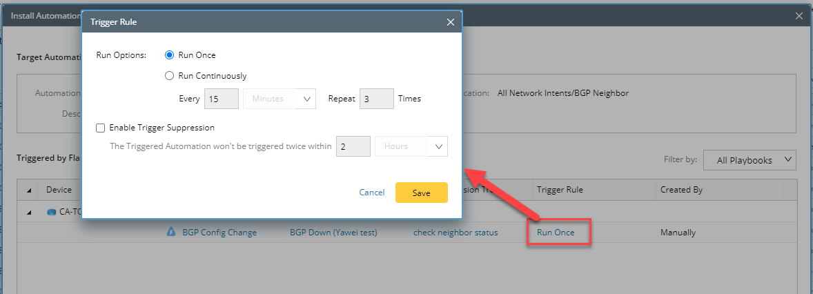

5.Define Triggered Rule.
1)Click Run Once in the Trigger Rule column.
2)The Trigger Rule window pops up.
Run options: Once(default) or continuously
Enable Trigger Suppression: to avoid multiple automations being triggered in a short time interval; After the option is checked, the Network Intent will only be triggered once during the defined time interval.
3)Click Save.
6.Click Save to add the Network Intent as Triggered Automation.

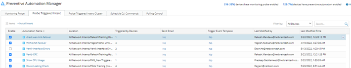

1.Click ,scroll down and select Preventive Automation Manager from the menu.

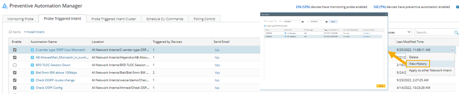

3.In the Last Modified Time column, select the desired automation and click . Select View History in the drop-down list.

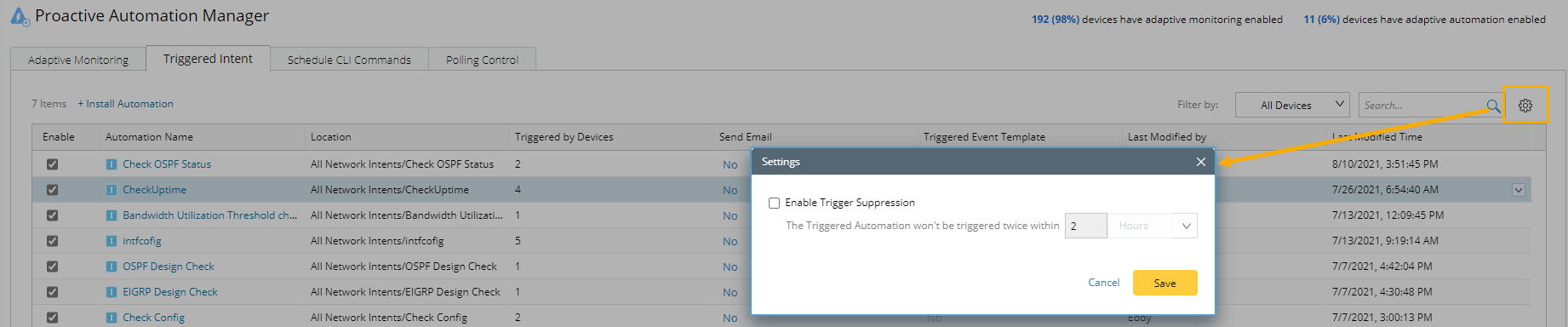

Global Triggered Suppression
2.Navigate to Triggered Automation tab of Preventive Automation Manager.
3.Click to enable/disable Triggered Suppression globally in the Settings window.
