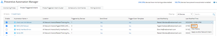

1.Click ,scroll down and select Preventive Automation Manager from the menu.
2.Navigate to Probe Triggered Intent tab.
3.Select the desired automation, in Last Modified Time column, click .
4.Click Delete from the drop-down list.
Note: After the above steps are completed, the deleted triggered intent(s) will not be displayed in Execution Tree, however, the triggered intent itself will not be deleted from the system.
