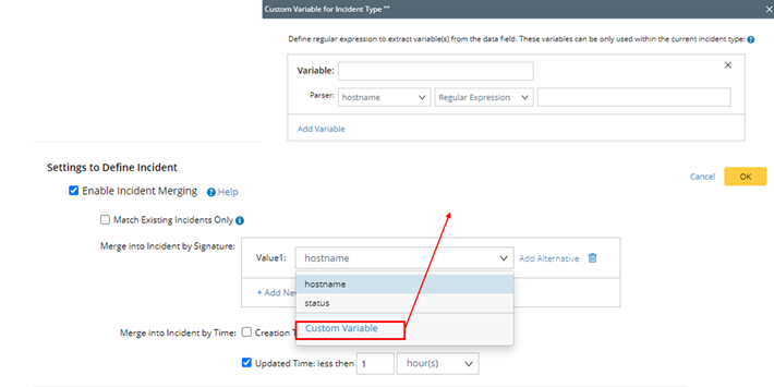

Merge into Incident by Signature:
You can select one or multiple data fields (or custom variables ) as the signature to merge the tickets to an incident.
a)Click Add New Value.
b) Select a variable from the drop-down list.
c)(When one value has multiple variables) Click Add Alternative to add an alternative.
Example: value 1 = Configuration_itemName or $device.
The use case for the multiple variables is that a ticket may use either Configuration_itemName or $device as the device name reporting this Incident.
Tip: The system will use the first variable with no empty value for the comparison.
d)When you want to delete a value, click .
e)You can define multiple values for the signature.
Example: For Interface Error incident type, you may define $device_name as value 1 and $interface_name as the value2. The tickets will be merged if both $device_name and $interface_name are the same.
oCustom Variable
The value used for the signature may be a part of a data field such as $description and $detail_message.
You can create a custom variable to retrieve the value from the data field by regular expression.
The custom variable starts with $.
