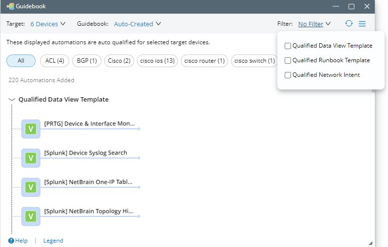

Type
You can filter recommended automations by type.
If Auto-Created Guidebook is selected: It displays auto qualified recommended automation. You can select from Qualified Data View Template, Qualified Runbook Template and Qualified Network Intent.
If a manually defined Guidebook is selected: You can select from Hypothesis and Data View Template.

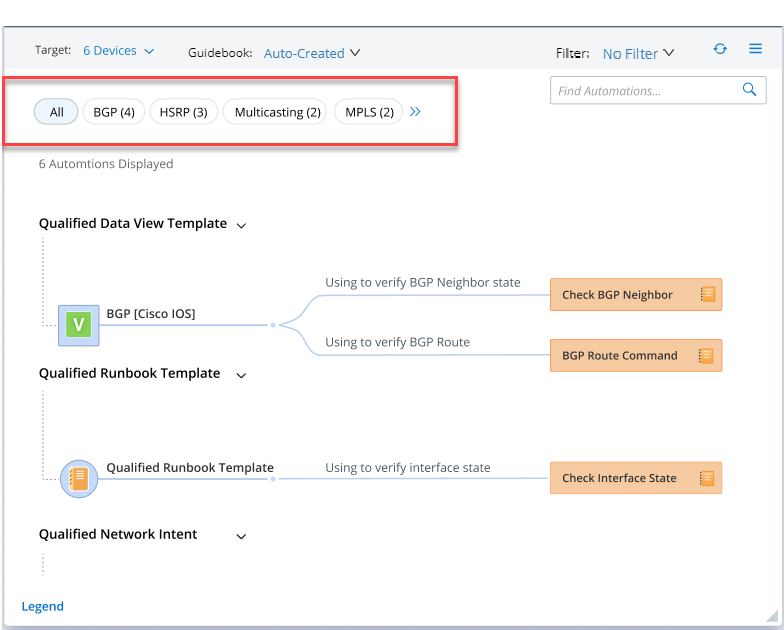

Tag
If tags are assigned to the Data View Template, Runbook Template, Network Intent and Network Intent Cluster, you can leverage tag to filter matched recommended automation.
Note: All is selected by default. It means all recommended automation(s) will be displayed regardless whether it has assigned tags or not.

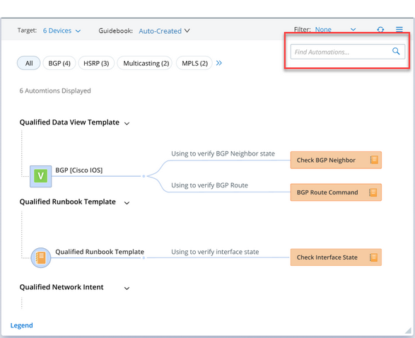

Keyword
You can input keyword to match the name of of Data View Template, Runbook Template, Network Intent, Network Intent Cluster and Hypothesis.
