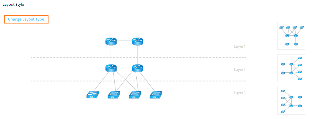

4.In the Layout Style area, click Change Layout Type to select a layout type suitable for your three-layer network.
Tip: To change the layout direction, click a thumbnail next to the selected layout type diagram.

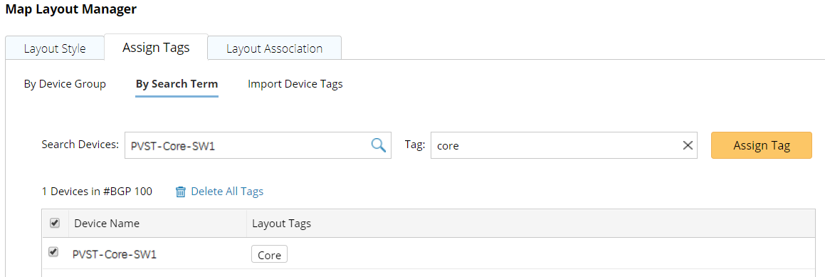

6.On the Assign Tags tab, assign layout tags to devices based on their role in your network. For example, if a device is in the core layer, assign the layout tag core to the device.
Tip: To delete tags from devices, you can click Delete All Tags to remove all tags, or point to the target tag in the Layout Tags column and click the
icon to delete the tag one by one.
