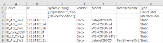

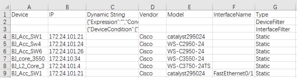

1)Click Import. 2)Select a .csv file with the required device information from your local folder. Here is a sample of the .csv file contained devices and interface: 3)Click Open. |
