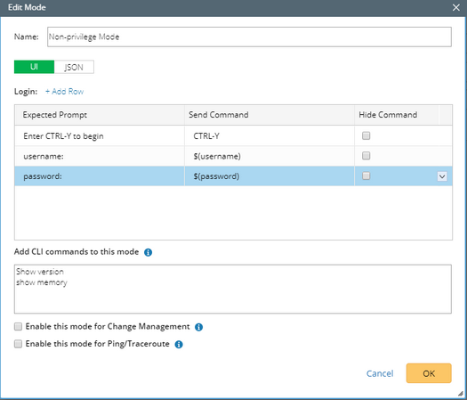

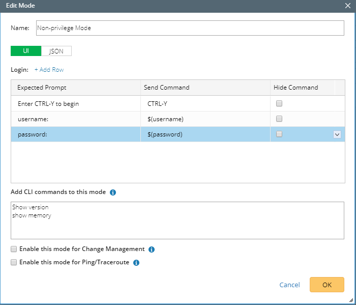

4.Configure the prompts and commands for a specific mode. Take Non-privilege Mode as an example.
1)Point to the Non-privilege Mode entry, click the drop-down icon and select Edit.

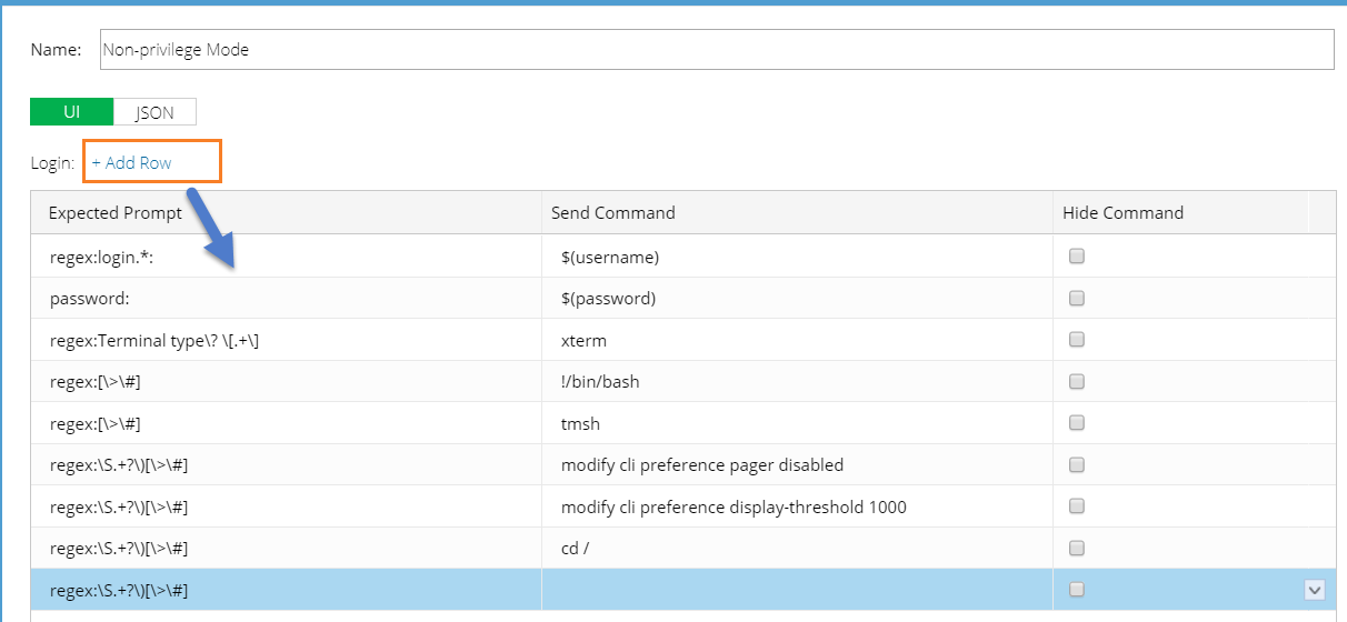

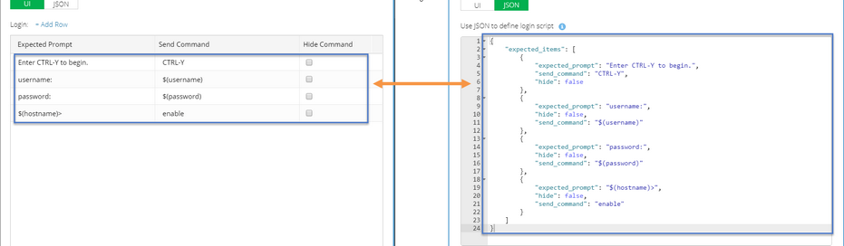

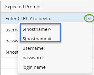

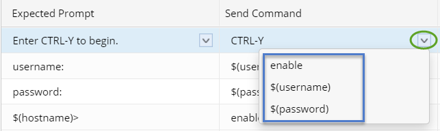

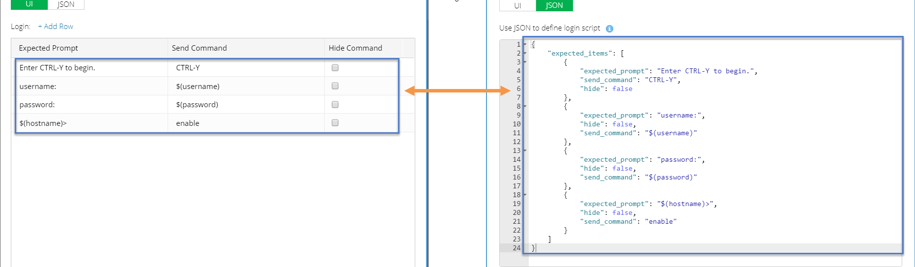

2)In the Edit Mode dialog, add prompts and commands by either of the following ways:
Add prompts and commands on GUI
Add prompts and commands using JSON script
Note: The content defined on the UI tab and JSON tab is synchronized with each other. Therefore, you can select either way to define prompts and commands for only once.
3)In the Add CLI commands to this mode field, enter the commands that can be executed in this mode.
4)Click OK.

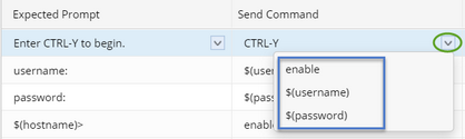

4.Click Add to customize more pairs of expected prompts and responsive commands.
Note: Use || to separate multiple expected prompts. For more rules and formats, refer to Prompt and Command Definition on GUI.
