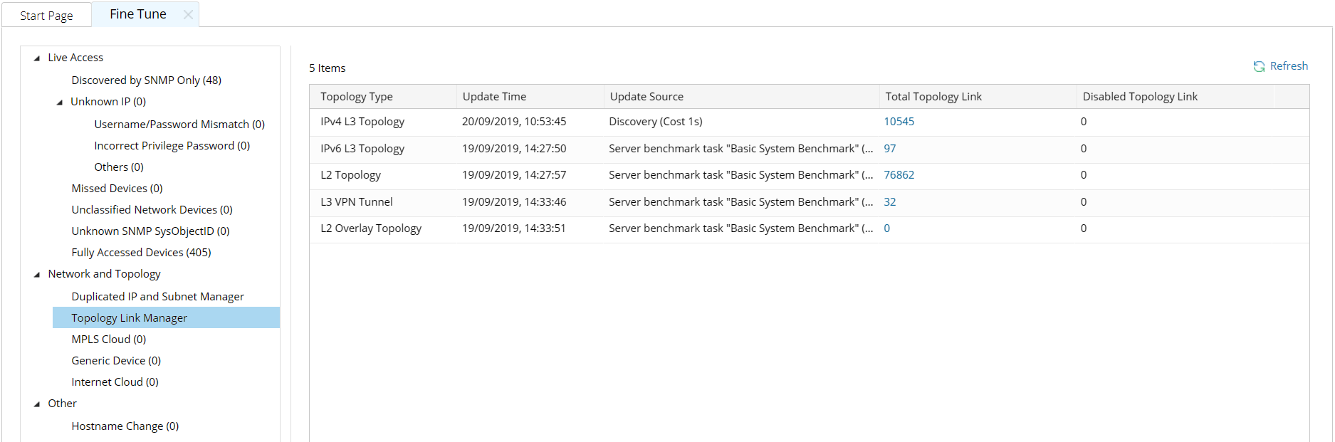

1.In the Domain Management page, click Fine Tune on the Start Page and then click Topology Link Manager on the left pane, or click Topology Link Manager from the start menu.

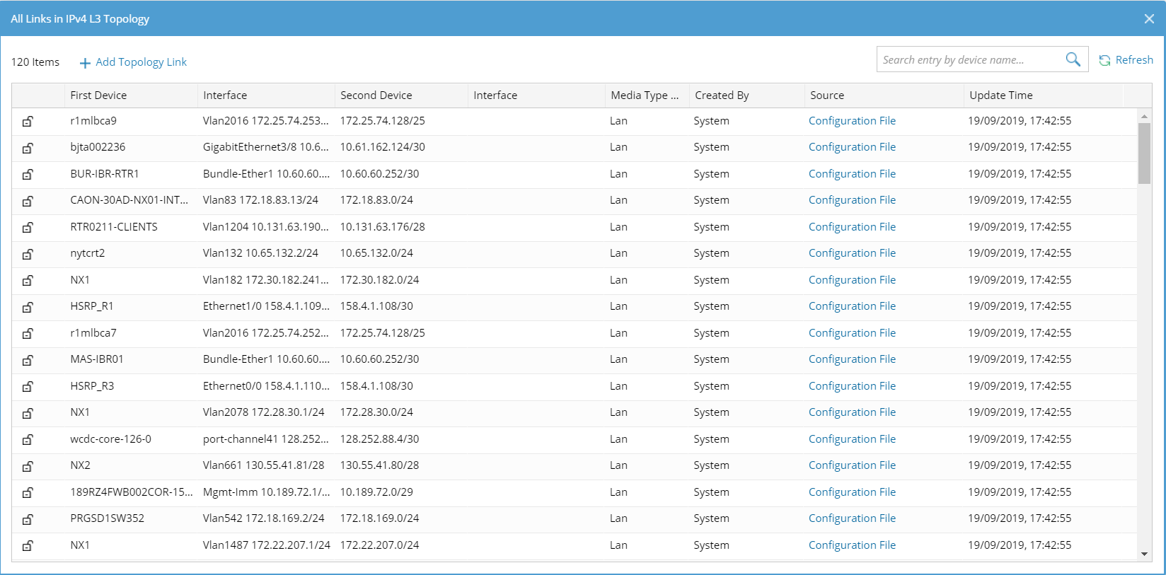

2.In the Topology Link Manager, select the topology type that you want to edit (for example, IPv4 L3 topology) and click the hyperlink in the Total Topology Link column.

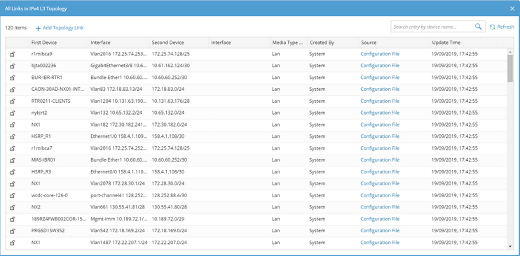

3.All links in IPv4 L3 topology are listed in the following dialog. Click Add Topology Link.
4.Select the first and the second device, and their connected interfaces for the topology link.
Tip: You can also select By Media from the Second Device list to select media as the second device. Media can be used to visualize point-to-multipoint connections among devices in a VLAN.
Tip: If the target device or interface is not found under the Default Zone, navigate to other zones. Zone is used to separate devices or interfaces of duplicated IPs in IPv4 L3 topology.
Tip: Only the interfaces contained the selected topology type are listed. The topology types that an interface supports can be parsed by its device driver or a Qapp.
5.Click Connect.
