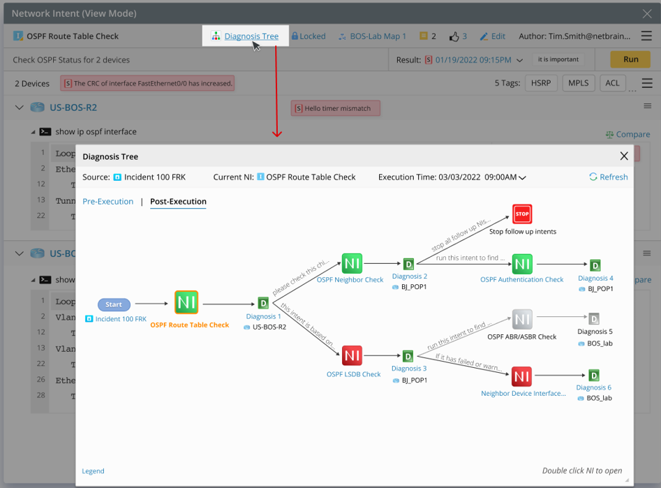

Accessing Diangnosis Tree
You can access Diagnosis Tree in the following three ways:
From Network Intent Editor/View
From Runbook
From Guidebook
The user can select any currently open NI to run, whether Home NI or Child NI. After the current NI and follow up NIs have been executed, the system returns to the View NI dialog.

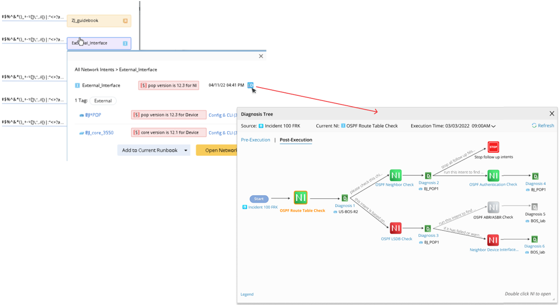

From Runbook
The NI in the NI node of the Runbook is still selected from the NI Manager, so only the Home NI can be selected. After the Home NI and follow-up NIs are executed, only the execution result of the Home NI will be displayed in the Runbook. The result of follow-up NI will not be displayed in the Runbook, and users can view the execution result of follow-up NI through the Diagnosis Tree.
From Guidebook
Only Home NI can be installed and shown in the Guidebook. After users run Home NI, the Home NI result will be displayed, but the result of follow-up NI will not be displayed. Users can open the Diagnosis Tree to view the result of the Follow-up NI.
