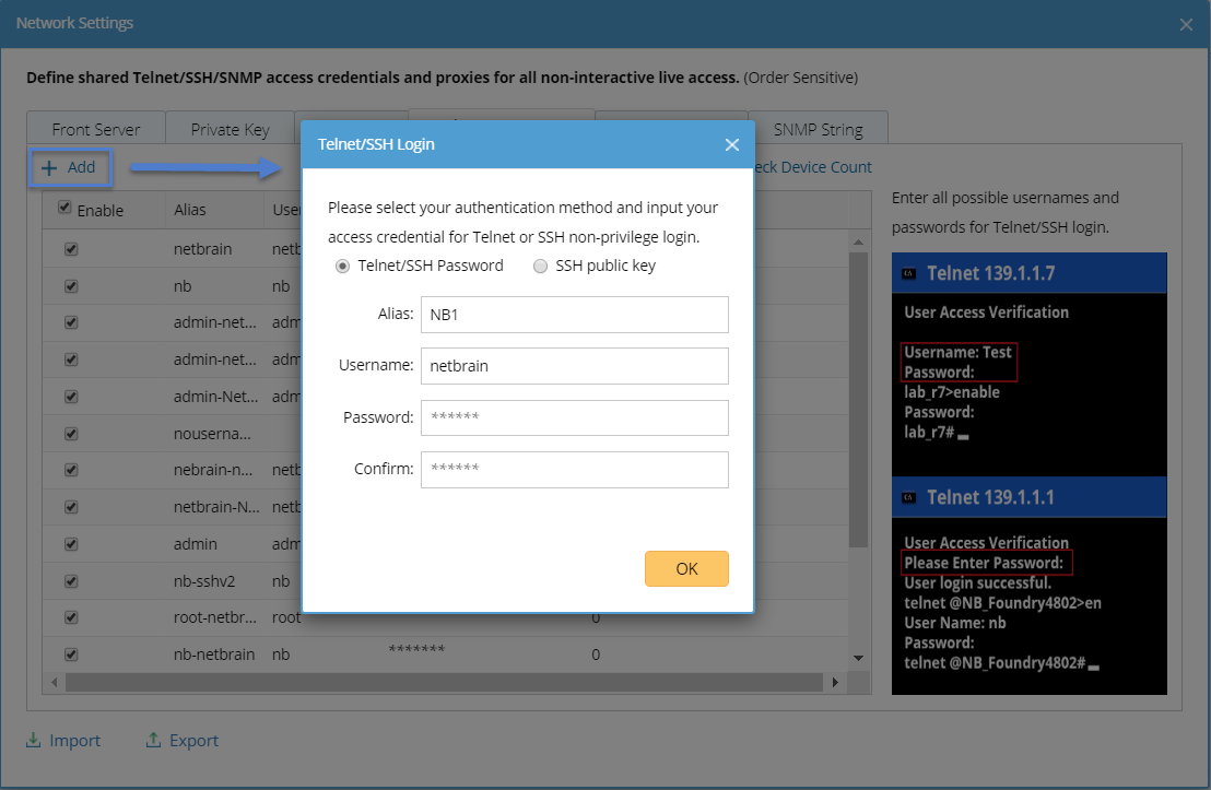

5.On the Discover tab, click Network Settings to add the matched Telnet/SSH login credentials.
1)Click Telnet/SSH Login > Add to add the matched Telnet/SSH login credentials and click OK. Repeat the operations to add all the needed credentials.
2)By default, the newly added credentials are selected. Clear the check boxes of proxies and credentials that are not used in this discovery.
3)Close the Network Settings dialog box.
