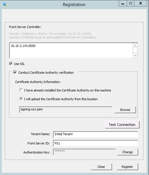

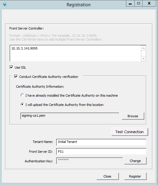

1.On the machine where the Front Server is installed, click the Windows start menu and then click the
icon to open the Apps pane.
2.Under the NetBrain category, right-click Registration and then select Run as administrator from the drop-down list.
3.In the Registration dialog, complete the registration form.
1)Enter the following information about the Front Server Controller.
▪Hostname or IP address with port — the IP address or FQDN Front Server Controller and the port number (defaults to 9095).
2)Configure the SSL settings.
a)Select the Use SSL check box to encrypt the connections to Front Server Controller with SSL. If SSL is disabled on Front Server Controller, leave it unchecked and skip step b) to c).
Note: Select the Use SSL check box only if you enabled SSL on Front Server Controller.
b)To authenticate the Certificate Authority (CA) of SSL certificates on Front Server Controller, select the Conduct Certificate Authority verification check box.
c)If the CA has not been installed on this machine, click Browse to upload the CA file, for example, ca.pem; otherwise, select I have installed the Certificate Authority on this machine.
Note: Only the certificate in Base-64 encoded X.509 PEM format is supported.
3)Click Test to verify whether this Front Server can establish a connection with Front Server Controller.
4)Keep all default values, and then enter the authentication key created when you add this Front Server to a tenant.
4.Click Register.

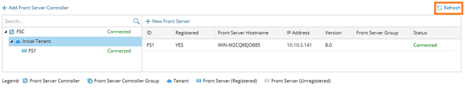

5.Click Close after the registration is finished. The Front Server information in the Front Server Controller Manager will be synchronized by clicking Refresh.
