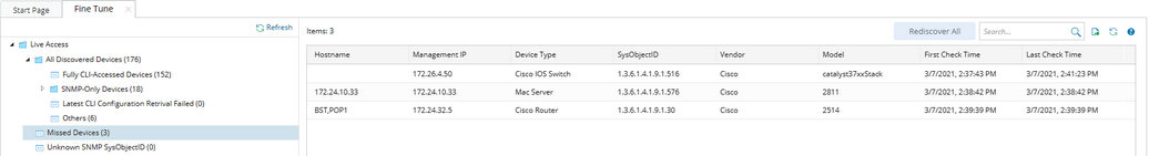

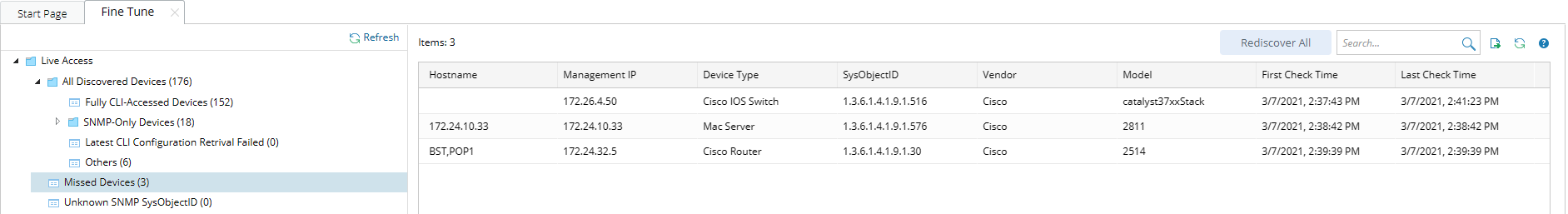

3.In the Fine Tune tab, click Missed Devices in the left pane. All missed devices in the last discovery are listed.
4.Select the devices, right-click them, and select Discover Selected Device(s).
