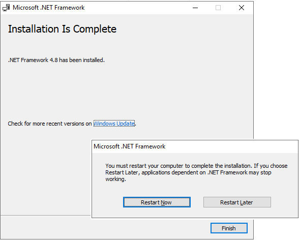

1).NET Framework 4.8 must be pre-installed on this machine before you install the Application Server. The Installation Wizard will automatically check this dependency. If it has not been installed, the wizard will guide you through the installation as follows; it has been installed, the wizard will directly go to step 2).
Note: Make sure the Windows update is of the latest. For Windows Server 2012, you might be asked to install some software patches before the .NET Framework 4.8 installation can start.

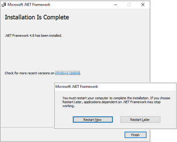

b)Read the license agreement of Microsoft .NET Framework 4.8, select the I agree to the license terms and conditions check box and click Install. It might take a few minutes for the installation to be completed.
Note: Some running applications must be closed during the installation of .NET Framework 4.8, such as Server Manager.
c)You must click Restart Now to restart the machine immediately. Otherwise, the upgrade will fail due to the failure of upgrading the new .Net Framework. After the machine reboots, continue with step 2).
Note: The interface above may not appear if the .NET Framework has never been installed on the server. In such case, it is still highly recommended to reboot the server after the installation of the .NET Framework completes.

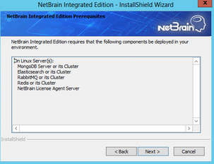

3)On the NetBrain Integrated Edition Prerequisites page, read the components that must be set up in your environment beforehand and click Next.

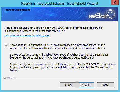

5)On the License Agreement page, read the license agreements, select the I have read the subscription EULA… check box and then click I ACCEPT.

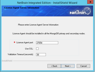

10) On the License Agent Server Information page, enter the following information to connect to License Agent, and then click Next.
▪License Agent port — the port number that the service of License Agent Server listens to. By default, it is 27654.
▪Use SSL — used to encrypt the connections to License Agent Server with SSL. If SSL is enabled on License Agent Server, select it; otherwise, leave it unchecked.
▪Validation Timeout (seconds) — it is used to set the connection timeout threshold (in second) to validate the connection to the dependent server. This will not affect the application running timeout value.

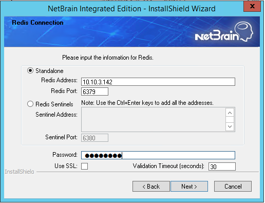

13) On the Redis Connection page. enter the following information to connect to Redis by selecting the Standalone mode, and then click Next.
▪Redis Address — enter the IP address of Redis.
Tip: You can enter the FQDN of Redis if all NetBrain servers are managed in the same domain.
▪Password — enter the admin password that you created when installing Redis.
▪Use SSL — used to encrypt the connections to Redis with SSL. If SSL is enabled on Redis, select it; otherwise, leave it unchecked.
▪Redis Port — enter the port number used by Redis to communicate with Web API Server, Worker Server, and Front Server Controller. By default, it is 6379.
