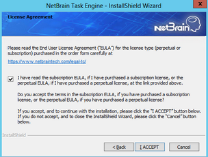

4)On the License Agreement page, read the license agreements, select the I have read the subscription EULA… check box and then click I ACCEPT.
