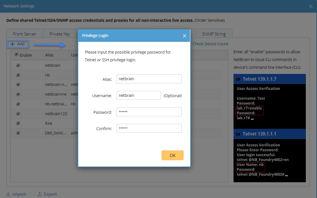

5.On the Discover tab, click Network Settings to add the correct privilege passwords.
1)Click Privilege Login > Add to add the correct privilege login credentials and click OK. Repeat the operations to add all the needed credentials.
2)By default, the newly added credentials are selected. Clear the check boxes of proxies and credentials that are not used in this discovery.
3)Close the Network Settings dialog.
